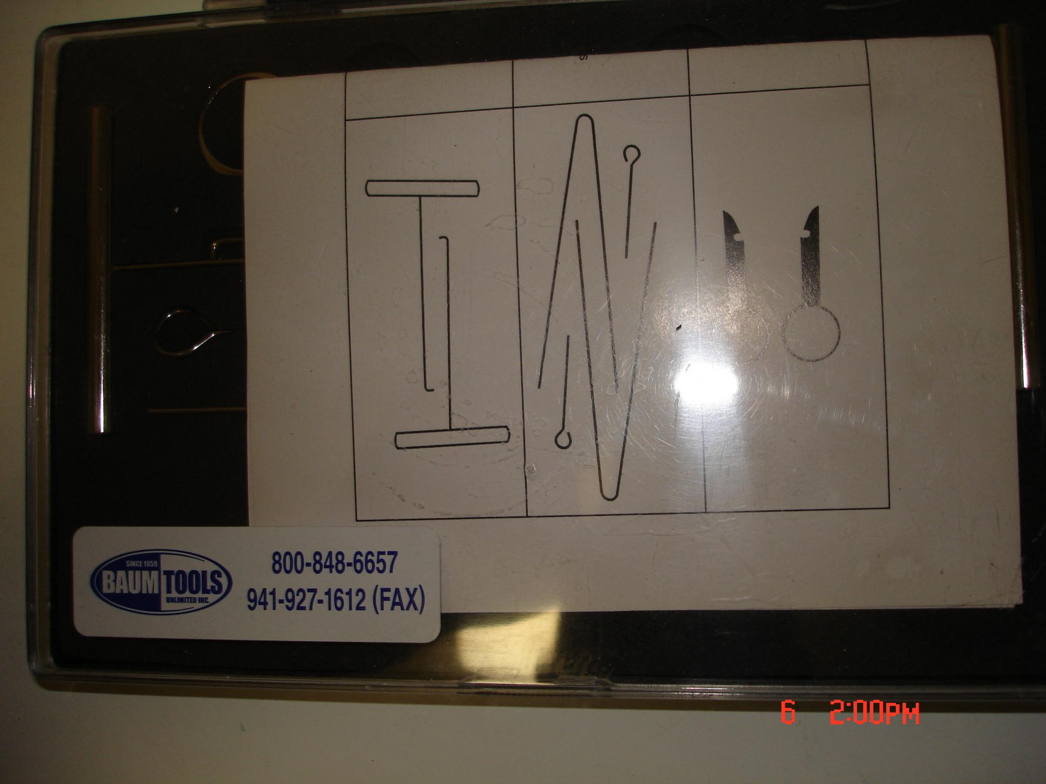

You can call BAUM Tools in Florida and get this tool kit that has Lock cylinder removal tools for
about $20.00.
(2nd Picture, Bottom Tool)
Along with Tools for Instrument cluster "Pulling" and Radio removal keys.
(800)949 6657
Owners who are Machine-ist DIY-ers have sucessfully made their own tools ,But It was just too
easy and cheap for me to get them from BAUM.
Attached Thumbnails Key Suddenly Won't Work-dsc01778.jpg   Key Suddenly Won't Work-dsc01779.jpg
