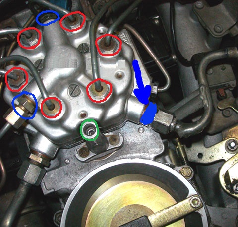

Pump has power, fuel pressure is present into distributor, Fuel comes out ports that are not injector ports. Fuel lines were disconnected at distributor, engine cranked, fuel inside the distributor was half way up the holes. Lines reconnected at dist and disconnected at each injector, engine cranked and same result-no fuel. I see two electrical connectors in this area, could this be electrical or is it strictly mechanical failure of the distributor? Well the saga continues.
Picture is like mine grabbed from internet.
Blue has fuel, Red does not,
Green is the adjustment screw but mine seems to have a metallic ball like item there blocking the inside where adjustment screws seem to be.

Ok watched a 70's video on that distributor, will try checks again with pushing the plunger in.

Ok so it seems there is a security plug inside my adjustment tower that I need to remove in order to make the adjustments. Its down in there so how does it come out, trim the tower?
