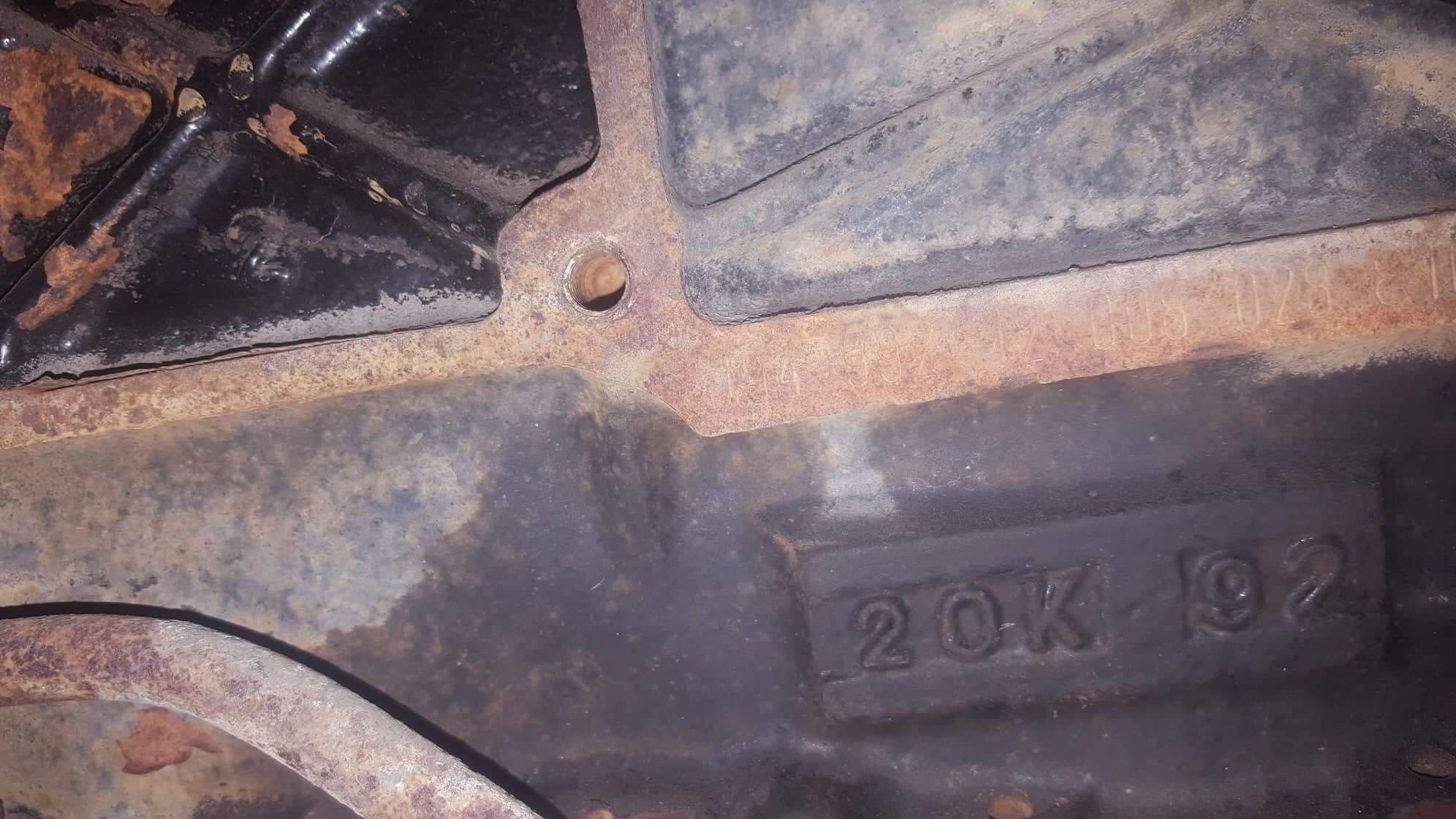

Hey, im buying 1990 model Benz 300ce (M104) and the guy who is selling it started a engine swap because original engine was leaking oil everywhere and it was burning oil also. He had two guys do it for him and the engine is from a s320 w140 I think. (I will post the block casting number). I don’t understand the rest. He says they removed both engine and transmission and installed the 3.2 engine with the transmission from the donor car and all it needs is engine harness and Ecu for the engine and transmission and also the old shifter cable did not work on the new transmission. How difficult would you think it would be to finish this job? I have made several engine swaps but not for a different engine and also I know the bmw so much better than Benz as I have newer worked on them.

What year S320 did your new motor come out of?
1990, you can't just put in any old 3.2l in there. 1993, the new HFM fuel injection system is not compatible w/the older CIS injection/ecu/etc.

I dont know the year of the car that the engine game out of. It came out of a w124 but the serial number is this WDB1240321B886329. Maybe you can see the year for the car that engine came out of?

And after talking to the dealer (I let them have the engine number and then they were able to tell me this vin number I was posting.) after talking to them we have found out that this is the ecu it needs A0135451532 And this is the engine harness A1244405232.

That Red engine shows an HFM engine.
CIS has a distributor and an aircleaner.
A lot of work to put in the former to put in a car that had the latter.
