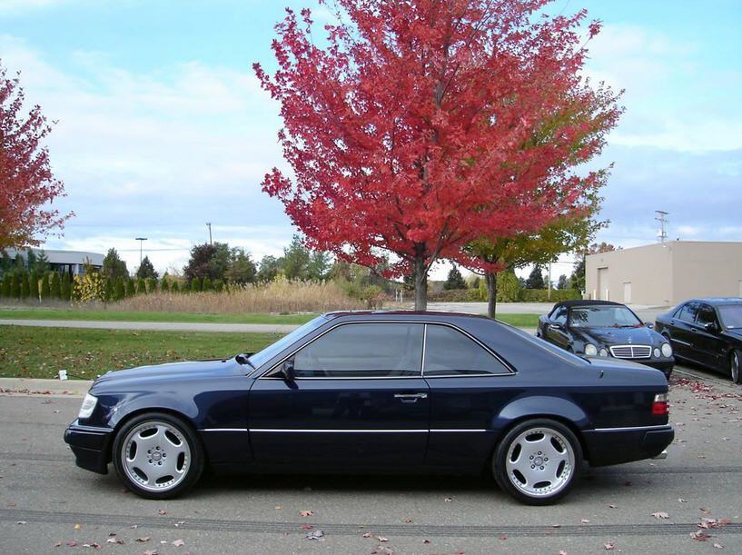

Any W124 coupe is a dream to me. I'm on my third in 20 years, two 1993 s and one 1995. My favorite was 1993 Sportline, Bornite color.
My recent 1995 Blue-Black (Blauschwarz) with 80K miles.
Sorry about the pic sizes, I don't know how to adjust them. Find one that is well maintained with service records, Dive and Enjoy
