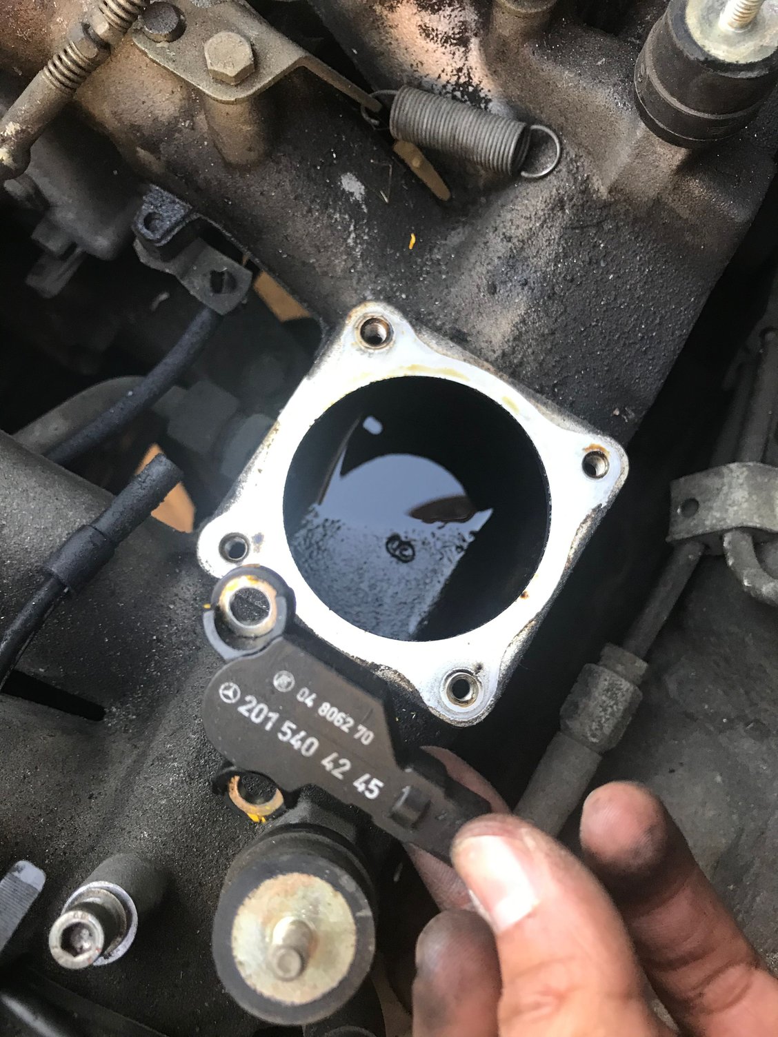

I have a 1992 Mercedes 300E 3.0L I just purchased. Can anyone tell me why I found a small puddle of fuel when I removed my throttle body. I’ve never seen something like this. Intake manifold should be dry, correct?? Take a look at the picture. Thanks and any feedback is appreciated.
Puddle of fuel at the bottom of the intake manifold when throttle body was removed. Why?

Normal. Crankcase ventilation and its the low spot

Thanks for replying. I thought I would have another problem on my hands. I appreciate it.

Leaking down from above because the fuel distributor cut off valve o ring is faulty /
