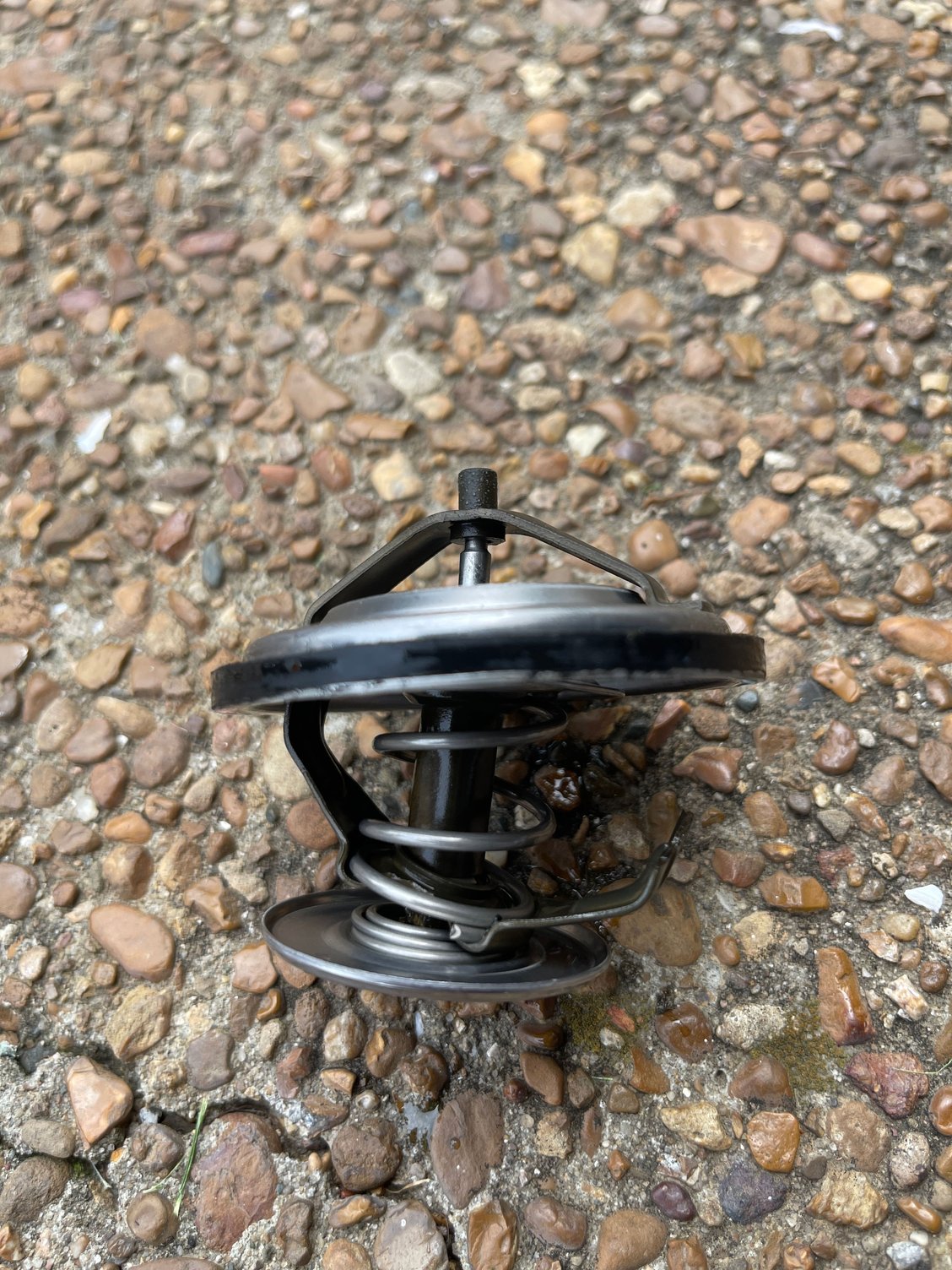

Well I found at least part of the issue. Was pulling things apart to just get an idea of the condition of the entire system and found the thermostat was completely shot. I’ve ordered a new one as well as new factory coolant. While I have everything drained I’m planning on take out the radiator and fans to clean everything out. There is a substantial amount of buildup on the condenser which I tried to remove with compressed air but was pretty unsuccessful. Thanks for the replies.
