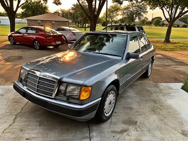

I have a 1990 300e I’ve been restoring. It has 80,000 original miles but it sat for quite some time. The cars in really good condition other than a refinished it because someone had left it parked outside.

If your getting no help ,then you will need to join the uk forum where there are lots of W124 owners to help you .. fantastic looking car by the way
