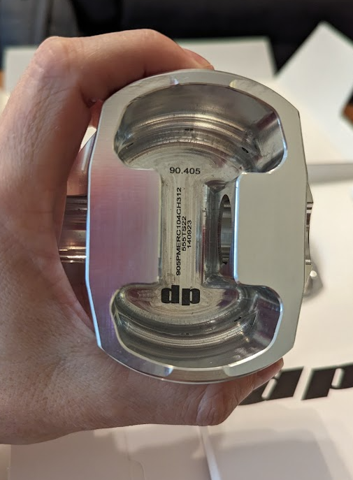

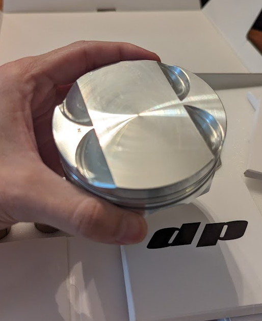

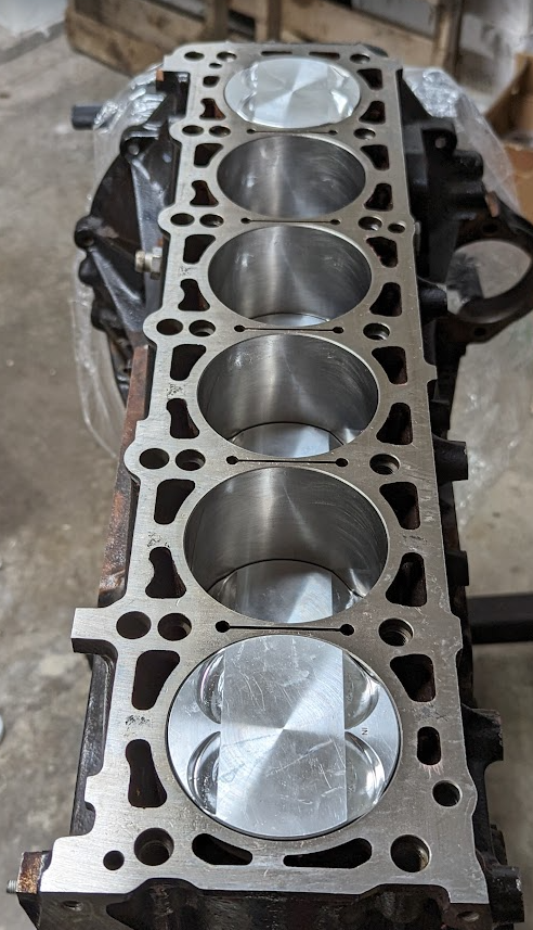

Just an fyi, I wound up getting pistons from DP engine parts out of Greece. Word to the wise, order before summer those guys take an extended break haha. But when they finally did come, the product was great. (knock on wood, it's all still getting assembled).

Looks great! FYI, last time I visited the delaership and asked them if they cell pistons/rings for a re-honed/re-bored engine. I was shocked to find that they do for a 2.6L M103.
It would have been kind of pricey though. What was the final cost of this? I will at some point need to do the same and am in the hunt of a low mileage engine to swap in instead.
