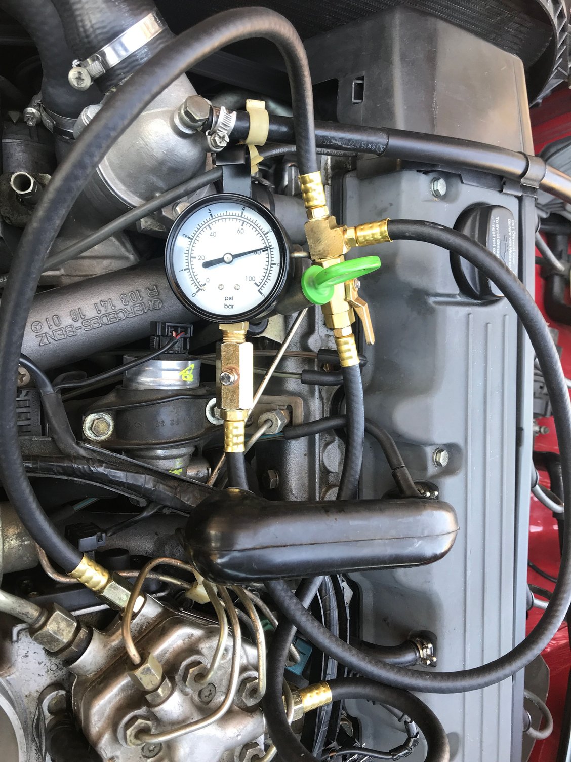

If you intend to keep your car for a long time I would instead buy a fuel pressure gauge and connect it to the testing port on the Fuel Distributor. It will tell you if there is a leak and how bad it is.
I suspect a leak in my engine for years. Turned out I do not even have a leak. This also is very non disruptive, and you are not potentially damaging injector seals etc. If you go your way, I woul purchase the injector seal kit first as most likely you will replace them.
If you do have a leak, there are many sources for that and your relatively new injectors are probably at the bottom of your list. Unless they were defective.
But you are very good with instruments, you should get a gauge. They are cheap, an in europe you should have trouble finding the metric brass couplings for the pressure gauge.
A bit harder here, though one meant for mercedes comes with the coupling.

If you want a good pressure gauge meant for these cars and you can find this in Europe, I would highly recommend this one in the picture.
- Cheers!
Reply 0
Jun 5, 2023 | 04:47 AM
  #37
Thanks, I was actually looking for that one because it was recommended in a video I have seen, but it looks impossible to find it on this side of the ocean.
