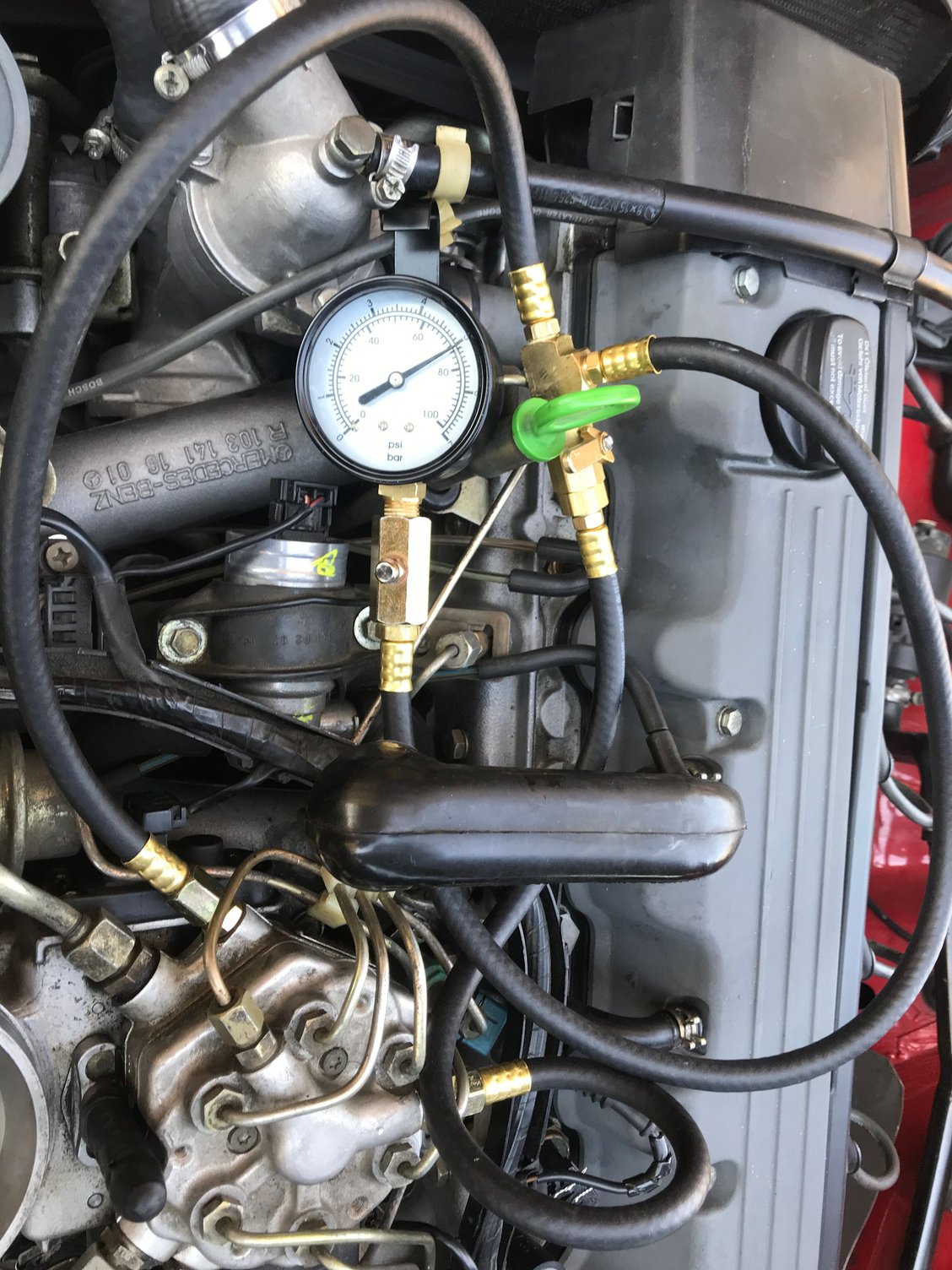

1. The cold start injector leaking thus running ok for a while till its flooded
dolucasi>>> I very much doubt this. Not a common failure mode but easy to test by removing and observing.
2. I have 2 fuel pumps should i try and disconnect one of them maybe the pressure is to high for some reason
dolucasi>> I would not do this. The pressure is not regulated by the fuel pumps. It is not their fault that the pressure maybe too high and both are needed to run the car, one is not enough.
dolucasi>> You already changed the FPR so that should have solved a high pressure but if you believe there is too much pressure you can not wing this diagnosis and throw parts at it.
dolucasi>> You need to spend $110 to buy the correct fuel pressure gauge meant for our cars with the correct couplings and fittings an a switch valve with 2 connections.
3. The fuel distributor is faulty and needs to be changed
dolucasi>> It could be, but you need to measure the fuel pressure first. Also your EHA valve could be faulty. They tend to leak before fail operationally so a smaller probability but something appears to be building pressure or keeping pressure after the engine is off, but with the fuel pressure gauge you will witness this too.
dolucasi>> So my advice to you is to buy the pressure gauge before doing anything else.
dolucasi>>> The one and only time my car had similar symptom to yours was when the FD went bad and had to be changed. I am the original owner of my car. the FD was changed at 150K miles. Car never sat and was used regularly. Currently mine is at 207K miles.
dolucasi>> How many miles on your car????
Any help or input is much appreciated
I bought this for ~$110 online a few years back
Control pressure
System pressure

There are multiple filters that would not allow larger particles to get thru and clog up things, but bad fuel, especially stale fuel is certainly not good for the fuel system in these cars. Once the fuel starts to turn into varnish you are in big trouble.
The dual input fuel pressure gauge is your friend, try to find one if you can in your country.
