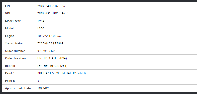

Figured id ask on here, see if someone can point me in the right direction of where to start looking. Heres his vin if it helps.
