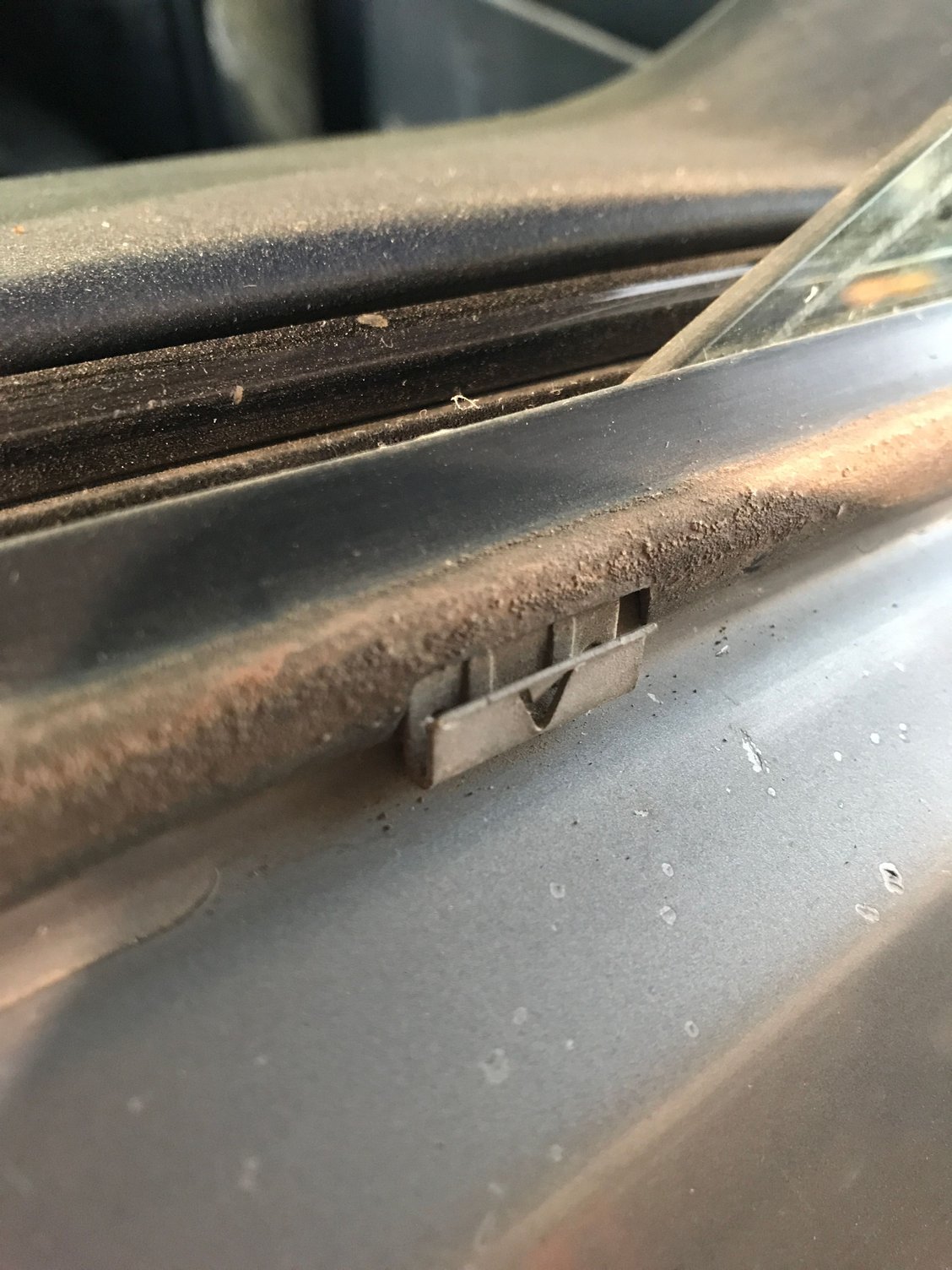

Hello All,
I didn't seem to have any luck on my search of the forum! I wonder if anyone knows the part number of these, if they might be available, or if a suitable replacement is available? They are the clip that holds on the window bright trim. In my application its on a 1988 W124 300CE. See picture below for reference. It seems they were removed by the previous owner and that they might have been spot welded on? Any insight would be much appreciated. Thanks A.

Just closing this off. The clips were not spotted in place, they are "s" shaped clips that hold onto the lower window seam and the trim. I found some of a later MB at the recyclers. Thx
