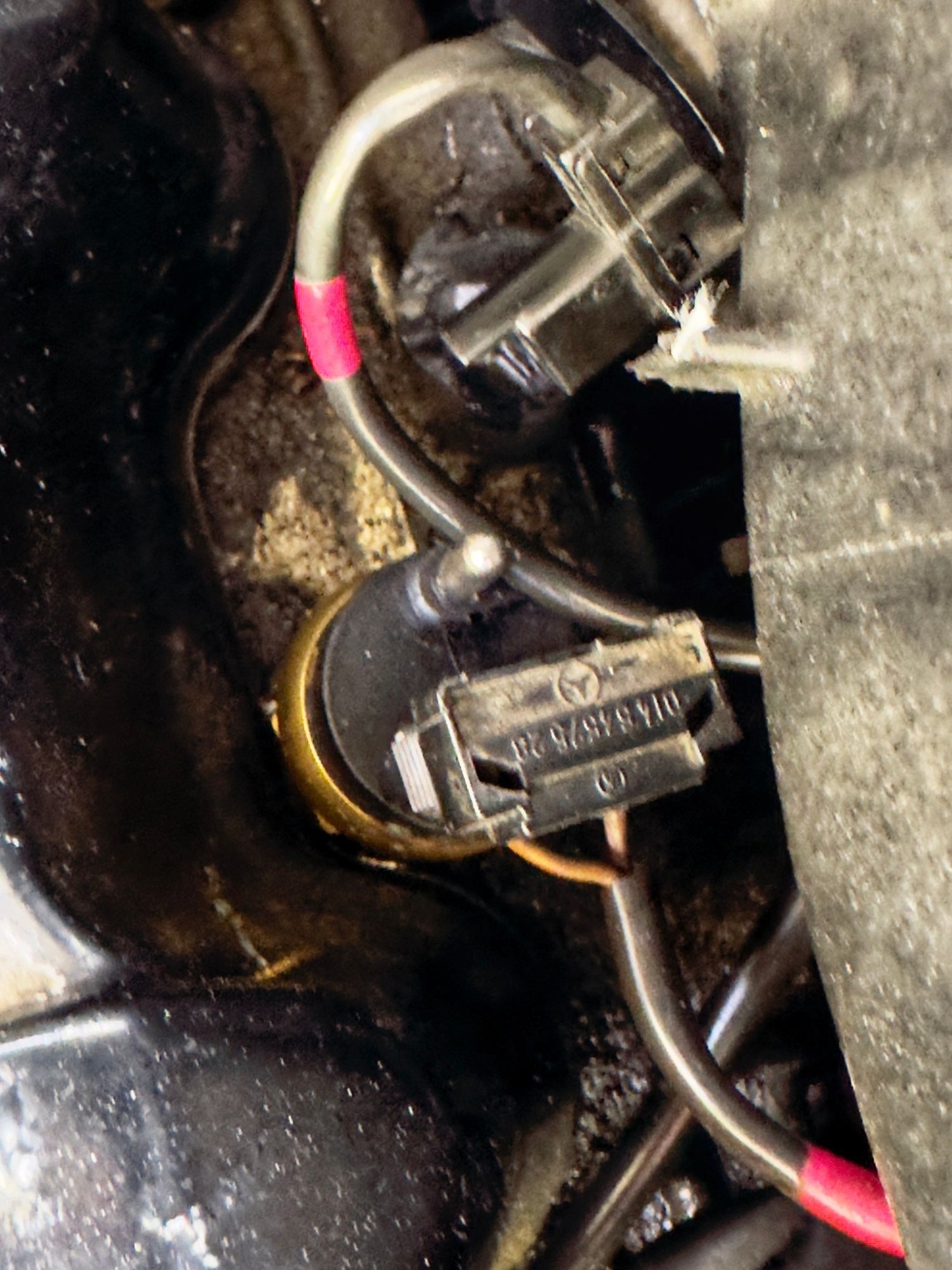

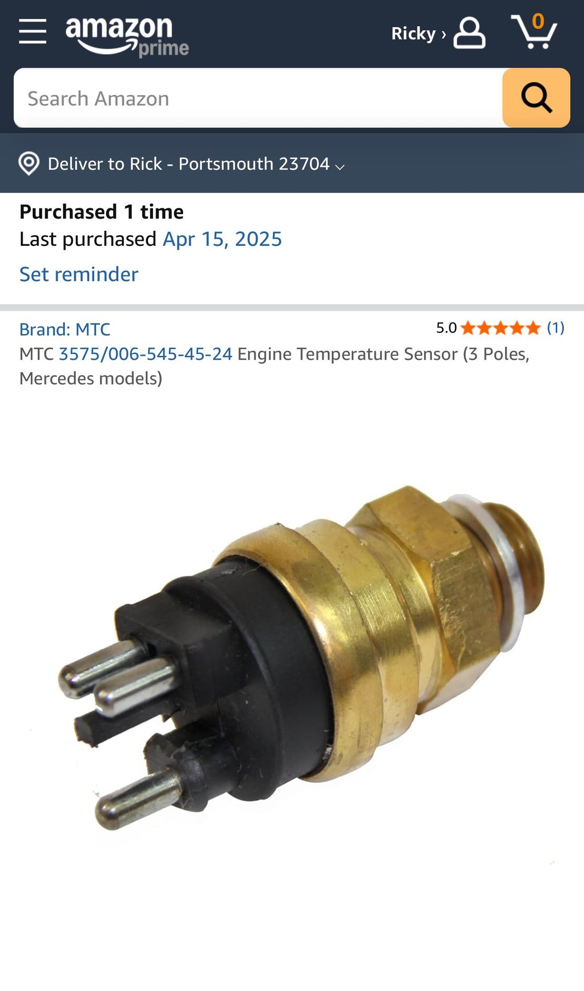

It wasn’t associated with the taillights. I had recently replaced this engine coolant temp sensor on my 1986 300E, and the aux fan would then go to high speed when the engine temp went up. However the A/C and Aux fan low speed would quit working after the car had been run awhile, but was not overheating. I pulled the single connector wire off the sensor and the A/C and aux fan low speed are working again. Wrong part???

Found this part which supposedly superseded the green one. Have it on order.
https://www.autohausaz.com/pn/006545...AAZ42325&gQT=0
