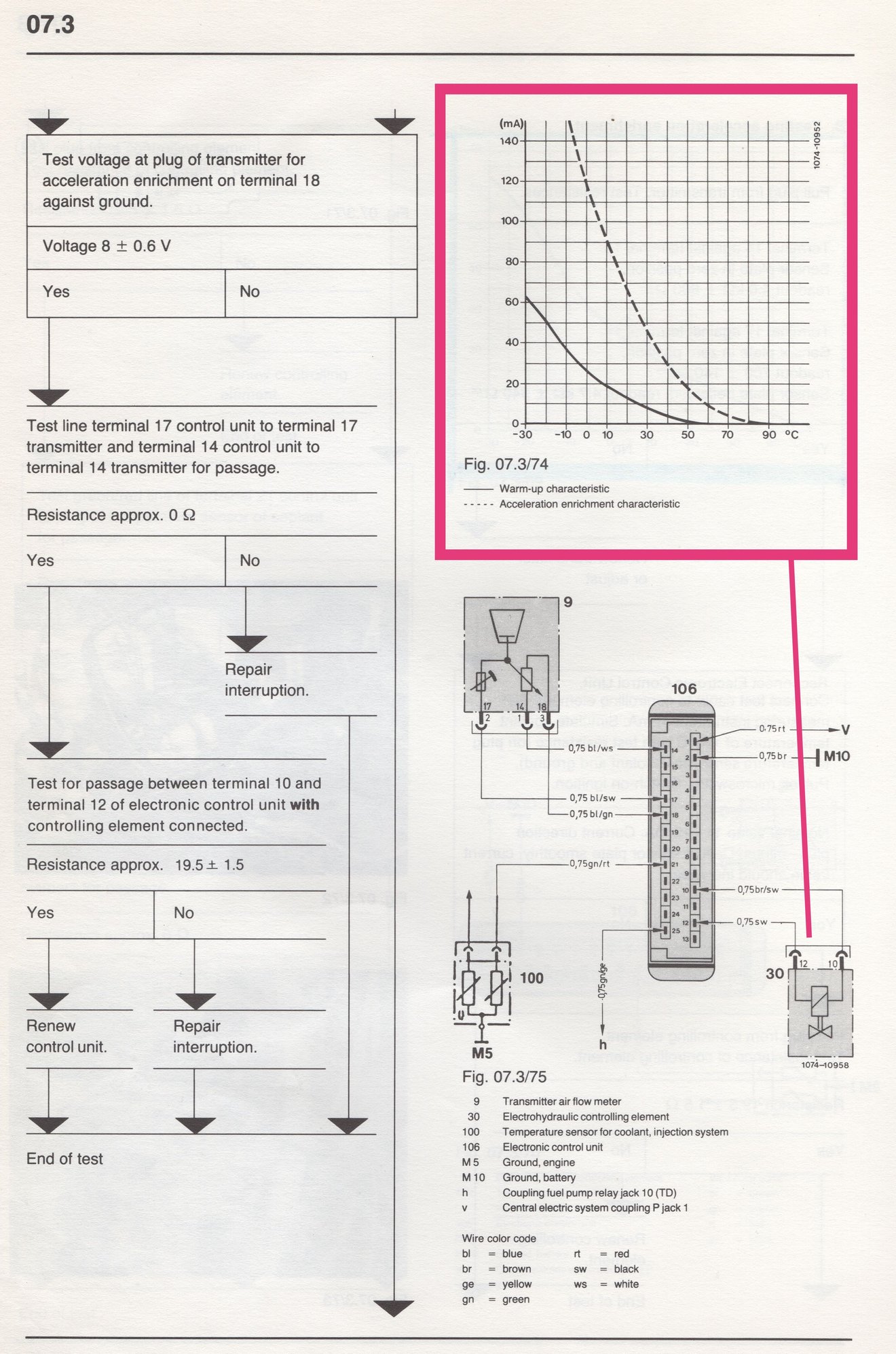

You should measure your EHA current during cold running and see if it more or less maps to the front part of this graph below.
Also do not overlook ignition components in case the issue is condensation in the distributor.

And if your cold EHA enrichment is not happening, it is possible that there is an issue with your engine coolant sensor signal getting to your ECU.
Have you ever tested that. See if you can get that resistance first at the sensor followed by the same signal at the ECU side by unplugging it.
Make sure your keys are in your pocket when you unplug the ECU. You do not want your ignition to be on when you unplug it.
Have you measured your duty cycle when warm? Is everything normal there? oscillating around 50%?

I should add that the graphic I attached above is for a M103 engine (2.6L and 3.0L versions). It maybe different for a 500E engine variety. Please take that into consideration going forward.
