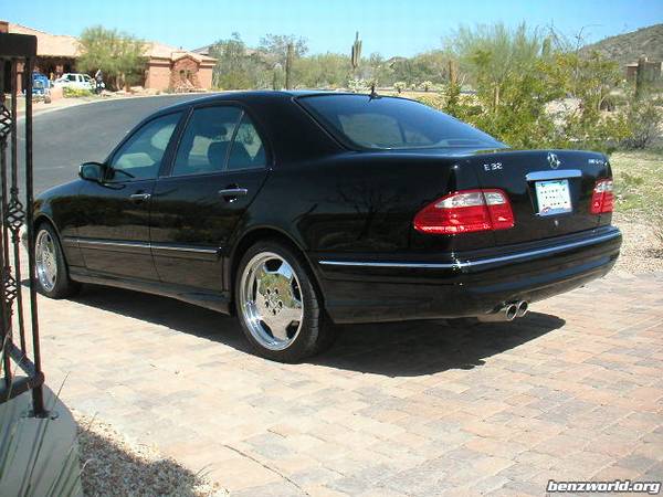

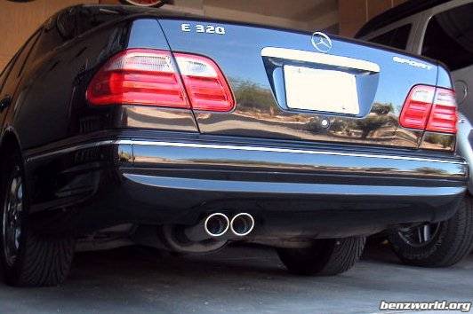

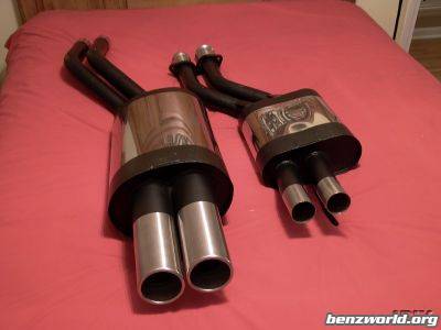

You can start by changing the exhaust. I went with a set of high flow cats and going with dual exhaust tubes all the way. This also give it an E55 look. It helps to swap the rear bumper cover as well or you have to knotch the lower part out. Go with a less restrictive intake setup as well. You can get rid of the mid muffler too. I liked how much better my 96 sounds and performs.

Exhaust was made by FOX and the cats are Magnaflo. Had no problems with emmissions or setting any O2 fault codes. My original cats were broken apart inside like what happens to most MB ones.
