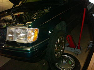

Hey guys, I found this link. Hope it helps someone here:
http://www.pelicanparts.com/techarti...eplacement.htm
Also I was able to reach it from below. Mine needs a 5mm allen wrenchy/bit.
Came out real easy. Photo's not to sharp, I had to hold up the camera without seeing the screen, but you get the idea.
It sits right above the starter.
Attached Thumbnails Crank Position Sensor for 1996 E320-dsc06552.jpg   Crank Position Sensor for 1996 E320-dsc06553.jpg   Crank Position Sensor for 1996 E320-dsc06554.jpg   Crank Position Sensor for 1996 E320-dsc06555.jpg
