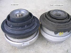

I will post the pictures of the old engine mounts later. Mounts were totally gone.

Engine Mount 98 W210
Pictures of of my new and old engine mount.
Attached Thumbnails Engine Mount on 98 E320-mount3.jpg   Engine Mount on 98 E320-mount4.jpg

Amazing height difference between old and new. Good job! Good pictures too!
