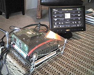

I'm currently working on adding a "carputer" or "CarPC" to my w210. It's a tiny (17cm X 17xm), low power, fanless motherboard with an 8" touchscreen LCD monitor. I have a special "smart" power supply that will sequence the startup, sleep/hibernation and shutdown with the car ignition.
What I'm trying to sort out is how to interface it with the Bose sound system. I basically have low level analog 5.1 sound outputs (2 channels each on those little mini headphone style jacks) or I can use a coaxial digital output. Can I wire up the analog outputs directly to the bose system? I can't tell from searching through posts if the bose amps take low level signals from most headunits. It sounds like a lot of people are wiring speaker level outputs to the bose?
Any advice or even speculation would be appreciated.

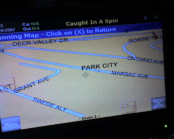

P.S. Pic of the system under construction attached. Eventually the screen is going to be molded into the dash. I may set it up to look like a Comand installation or I might actually move my AC/heater controls down to where my cubby is right now. Also might relocate the hazard and other switches up top so that the screen is way up high by the vents.
Attached Thumbnails The MB Carputer Project-carputer.jpg   The MB Carputer Project-gps.jpg
