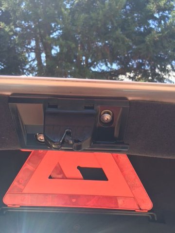

Old Jan 21, 2016 | 04:02 AM
KKC27's Avatar
Joined: Aug 2004
Folks,
Unable to open trunk via FOB or Switch on dashboard.
I can only open via key, by turning anti clockwise to 10 Oclock and then push to open.
How can I adjust the latch . It was working perfectly ok till I touched and spray WD40 due to hard to close.
Help PLEASE

Speaking in English, the blade key need to come off the tumbler in vertical position for remote operation.

Originally Posted by KKC27
Folks,
latch adjustment is generally done via the floor plate and the 1" round plastic bumper stops
