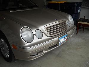

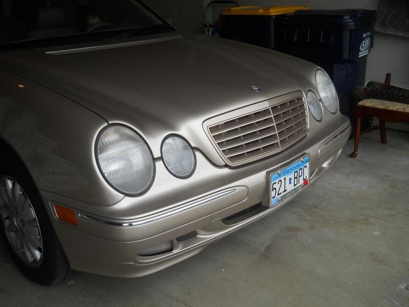

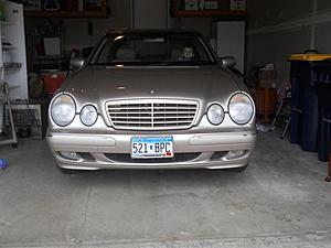

I painted my grill the same color as my car last night (desert silver), and it turned out more of a dark gold than desert silver. I was wondering if anyone knows how to go back and maybe lighten up the color after it's been clear coated.

Reduce your paint by 50% for the blend(the one you just sprayed with). It'll get lighter. That's if you sprayed it with a air gun like SATA, etc. Cans are not always the greatest with color matching.

Holding the gun further will not make it lighter. The paint will only dry faster because it's further away from the item you are painting. If you reduce the paint, it will get lighter. Thats how some fade like fenders to doors or hoods to make the paint match better.
You don't have to sand all the way down. Just color sand(wet sand)it with 1000-1200 grit and respray it. If your first coat was rough, you can wet sand it with 600 grit. Then you can spray your color on again.

The grill looks darker also because you are spraying a flat surface which reflects less light than the convex curved surfaces surrounding your grill. Paint match with a metallic is near impossible to match perfectly, depending upon pressure, distance from surface, angle of spray, speed of pass, temperature and humidity for flake layup, etc. The big one here is the first one listed due to light refraction from differing surfaces.

Yeah my grill is about as good as it's going to get for an amatuer like myself. In some lights it looks right on and in others it looks dark gold. Now I'm trying to figure out if I cant get the clearcoat to shine more.
