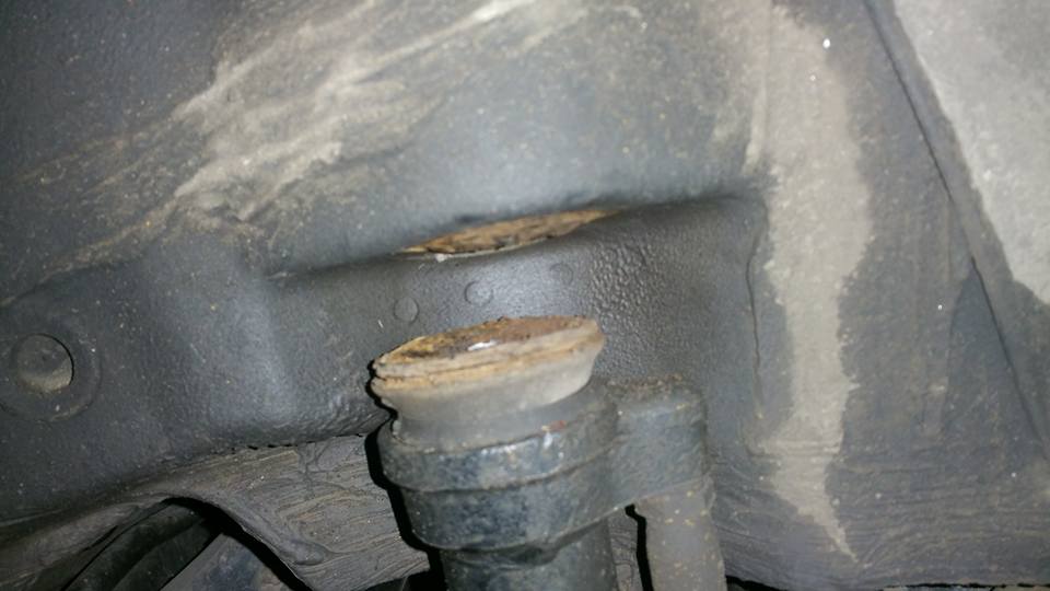

Hey everyone, so yesterday my rear shock broke. And we are going to replace them tomorrow. My question is once the new shock is in, do we need to add hydraulic fluid. It does not have air ride. If we need to add hydraulic fluid, how do we bleed the shocks and drain the old fluid? We haven't ever replaced them before. I really appreciate the help. Replacing Rear Shocks Help-shock-picture.jpg

The shocks finally showed up. when he removed the old shocks he unhooked the hydraulic line, the fluid came out. The question is how do we pressurize the new hydraulic fluid. Or do we fill the shocks first.
