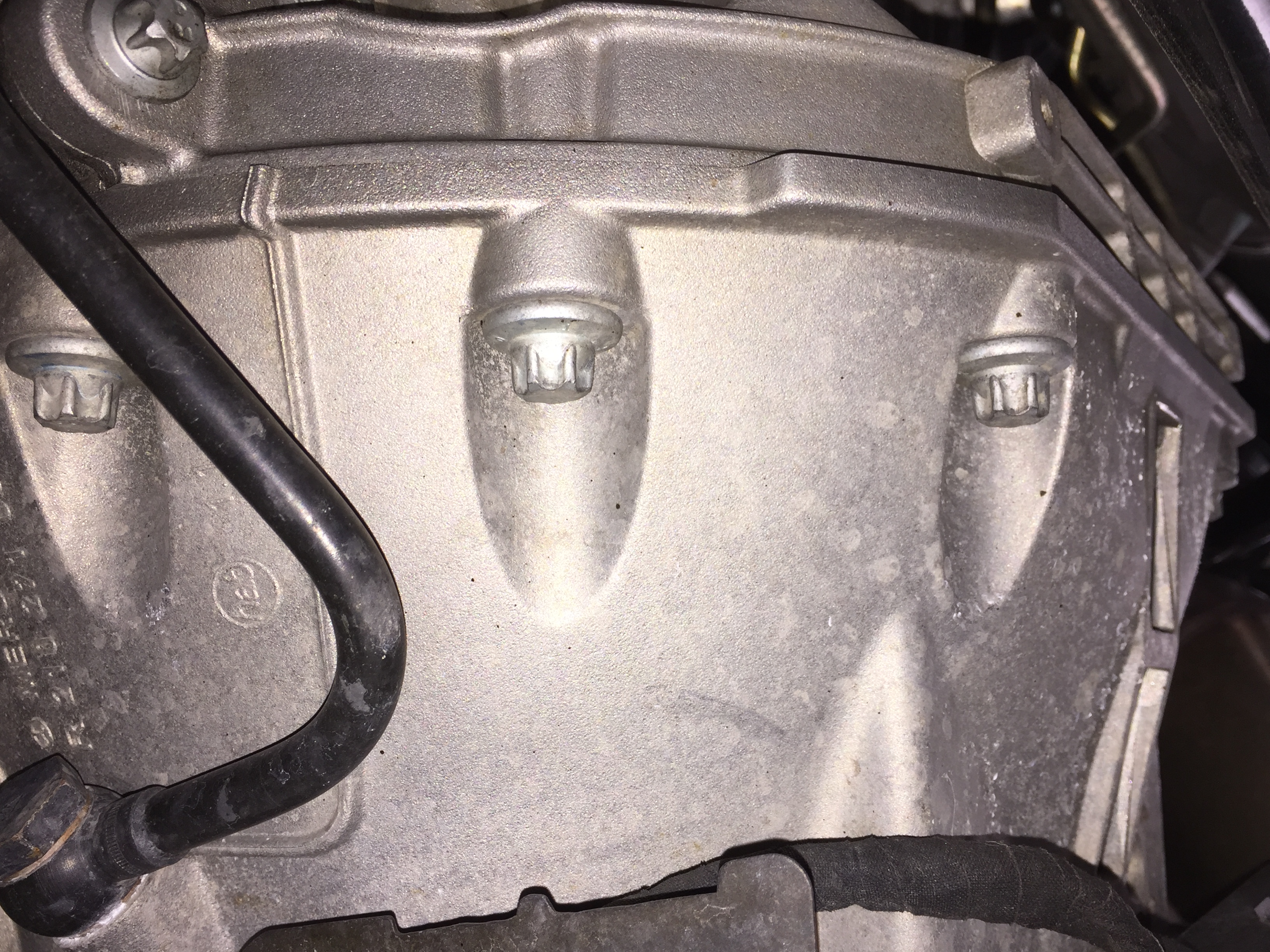

Something doesn't look right. That doesn't look like a 722.6 and it doesn't look like a 210 chassis. Look at the photo from a 1999 E-Class - a 722.6 in a 210 chassis. If you don't know what you have you really should take the job to a shop. And if the photo is an anomaly - I've done several of these R&R's. You REALLY need to know what you are doing to do the job right - and SAFELY.
