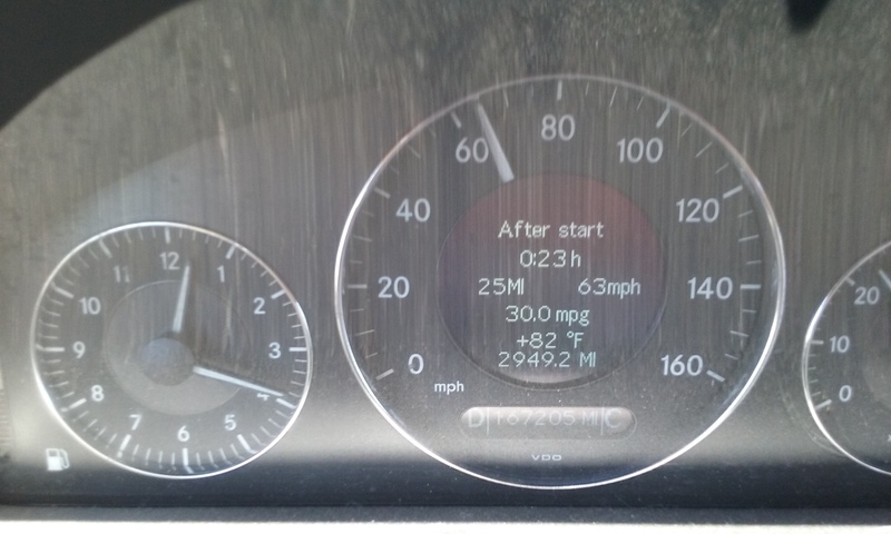

1922 Ford Model T / no OBD
Brick under right foot works.
This is 320 wagon 4M when I wanted to show-off
