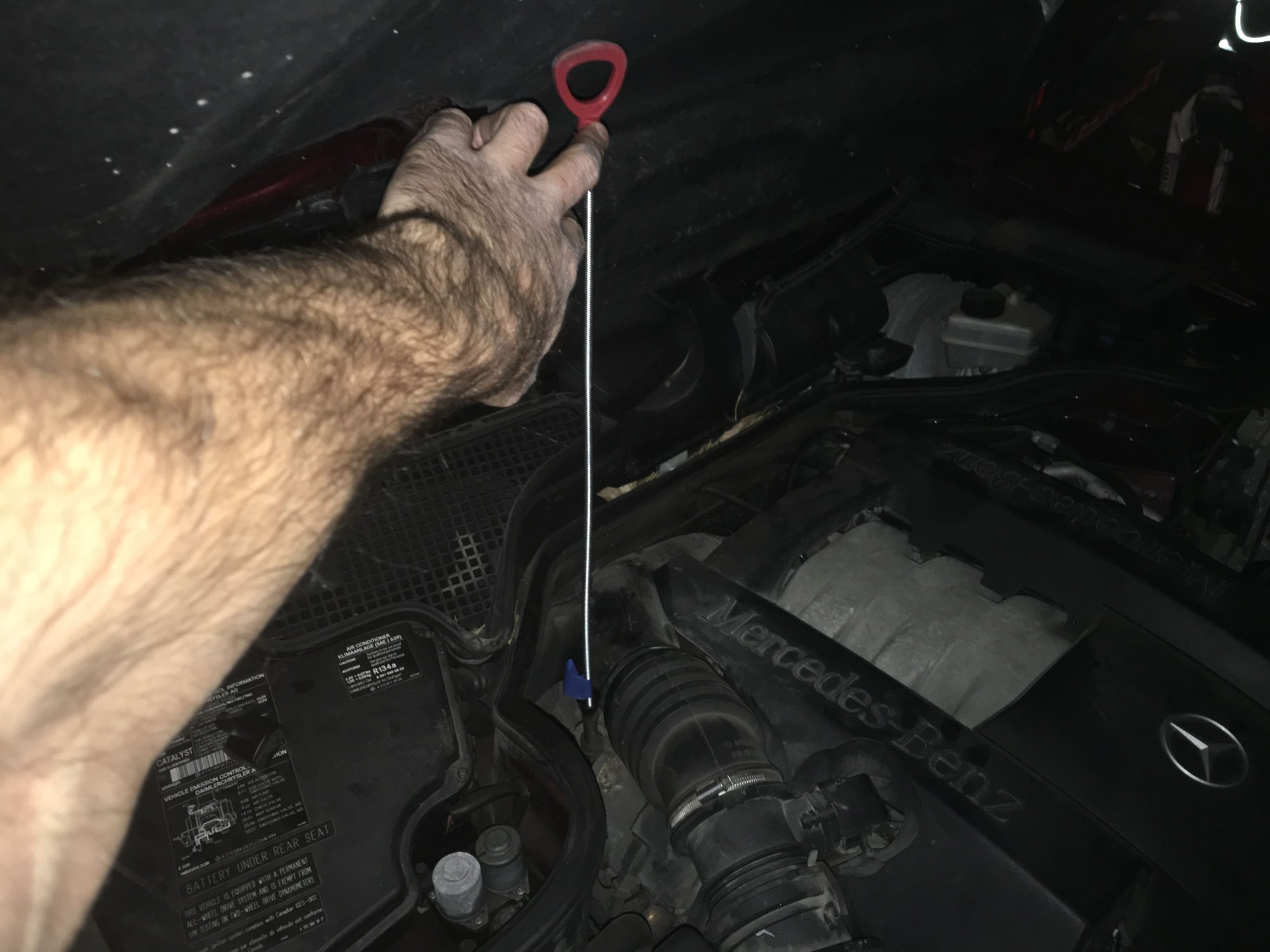

I had this sitting for almost 6 months in the garage before going back at it again and when I started her up a couple days later I had a dime spot of oil on the floor. When I moved the car I noticed a few more. Nothing serious, really small spots.
I crawled under her and noticed some wetness around the bellhousing of the trans to the engine but I also noticed the wetness was up the sides.

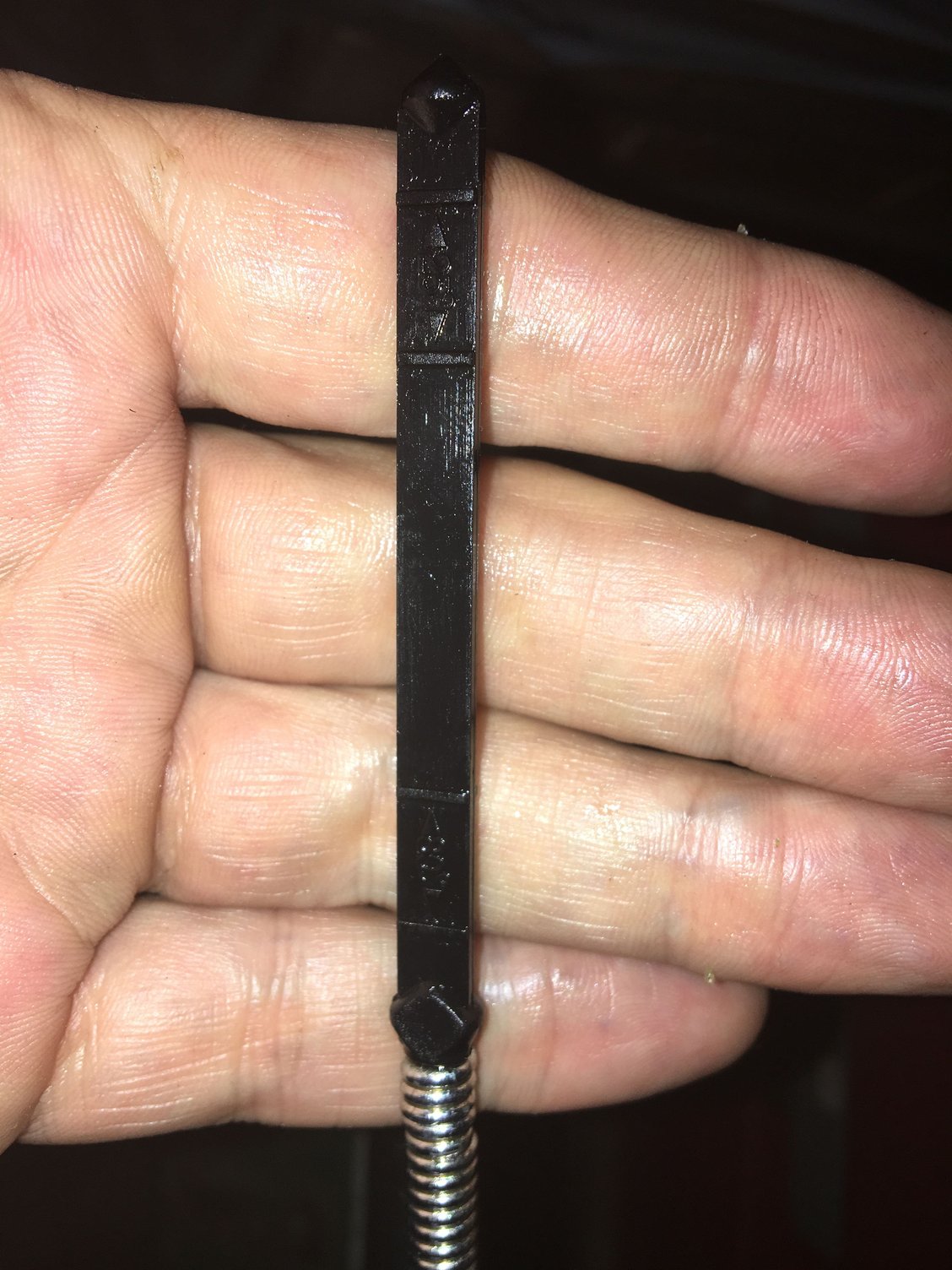

I ordered a transmission dipstick to check the level and found that after pushing the rod into the dipstick past the last curve, the measurements were showing that the transmission was packed with oil past the 80 degree right past that to the metal coil.
"No way" I said to myself, I had to be reading this wrong. The trans job was done by a pretty good group (indy garage) and that was 2 years ago! Not to mention, I moved from Winnipeg, Manitoba, Canada all the way here to Albuquerque, New Mexico and there's never been a single issue of any problem related to an overfill.
So I must be using this stick wrong. So I went online and tried to find as much info as I could about this trans dipstick and what I found was a confusing mishmash of all sorts of conversations with most saying that the dipstick itself cannot be pushed past a point it shouldn't go. ie...if I've got it pushed to the oil pan opening that is correct as it cannot go further and ergo, I've got a transmission with too much fluid in it!
Even worse, I've got a transmission that I topped fluid into while I was thinking I had the dipstick in the right position sitting in about 31 inches in. (it goes in farther)
So now it would appear I need to pull the drain plug and empty out fluid today.
Am I correct? Does this dipstick go all the way in until I cannot push it further?
The tape marks on the photo demark where I believed the stop point was for this dipstick but I'll bet I'm wrong there too. I kept trying to feel a stop point and that was due mostly to my imagination and not wanting to accept I've now got an overfilled tranny.

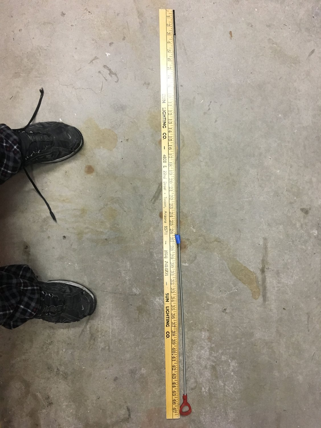

48 inches long.
This was where I thought I felt a small resistance to moving the dipstick further but that's more or less in my head. I marked it at 26.5 inches

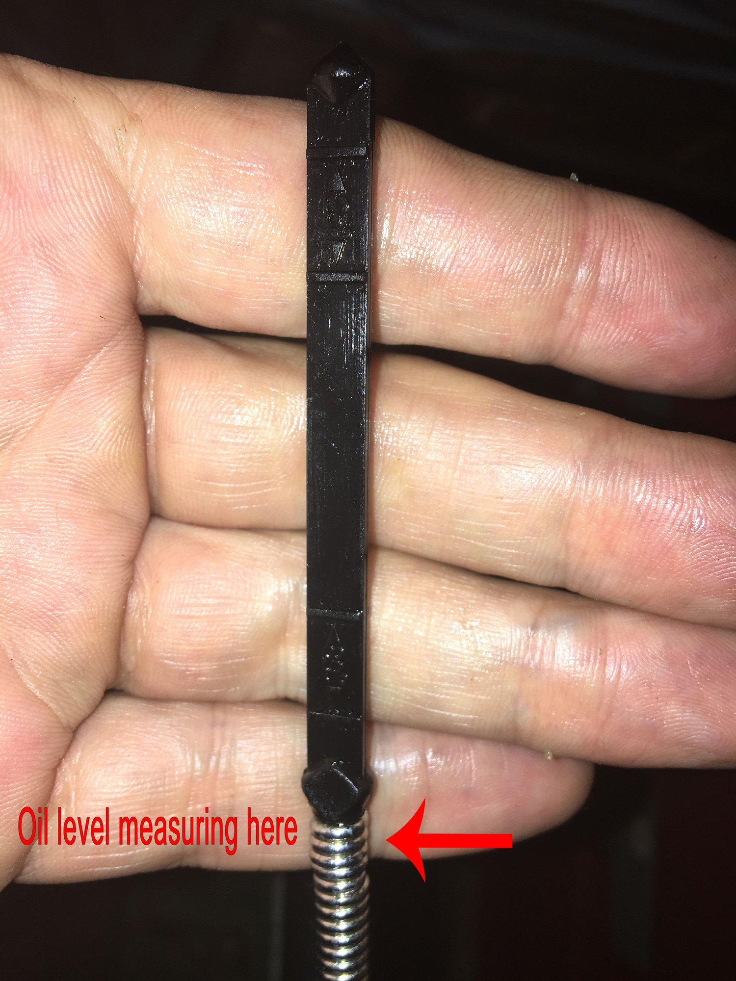

Hey everyone. I went for a 50 minute drive came back and redid the readings and they are a bit high due to my adding a half liter in on my earlier misreading. This is an earlier picture with an arrow indicating where I saw my new reading.
