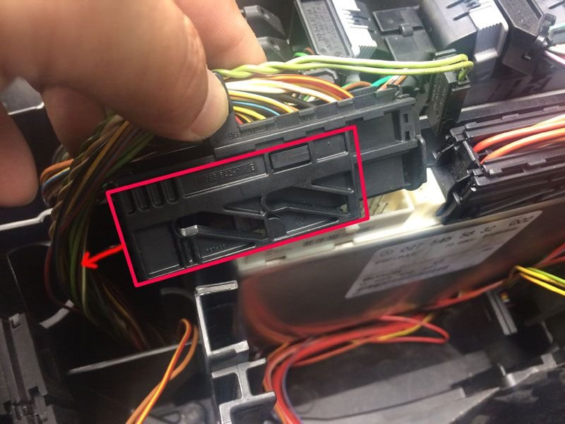

▼remove the socket plug from the ABS computer, you can slide the red part toward the arrow, the the socket will jump up.
if not, you need to strength your finger power.

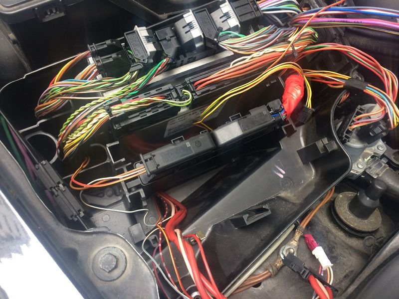

▼remove every wires and computers, you can see 5 8mm bolts in red circle.remove it. then you can move out the upper box.

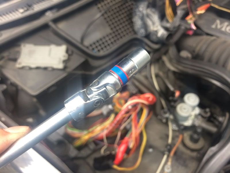

▼lose 4 10mm bolts in the red circle here, it's a little bit tricky, you need a angle socket to do it. Do not remove the whole screw, pay attention don't let it fall out.
▼You need this...

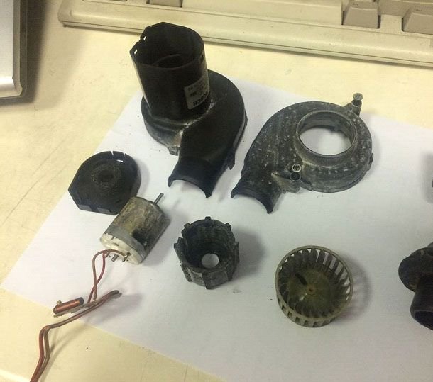

▼Take apart this small blower, pretty easy, no screws.
▼Use the screw driver, reach in the gap between the fan and the housing, then turn the screw driver.
fan will move from the motor axle.
▼Be ware of the gap, don't let the fan touch the housing when you put the fan into the new motor.
You'd better turn it and check if it turn smoothly or not.

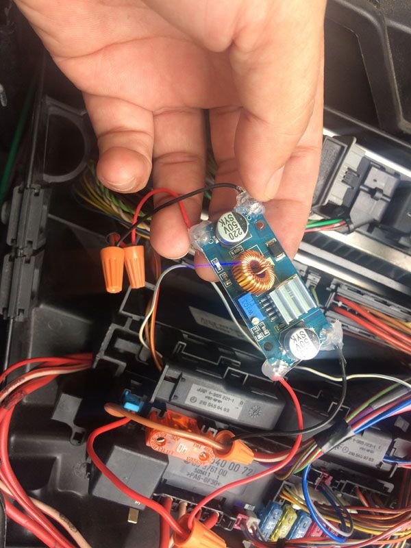

But I found out the new motor is spin too fast, it became pretty noisy while I turn the key on.
So I put a small device to lower the voltage, for let the motor spin slowly.

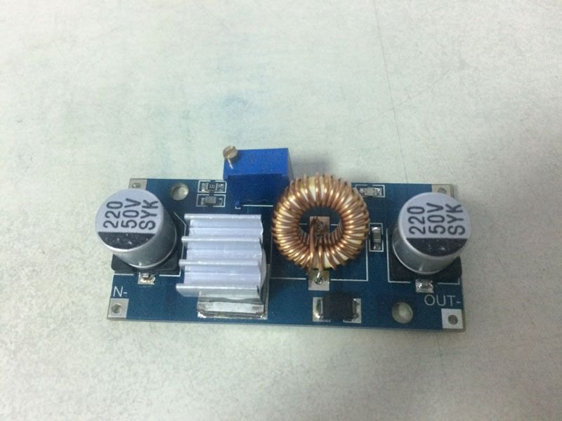

▼This DC-DC lower voltage module, pretty cheap, cost me USD2 here in Taiwan.
▼Put the wire on it first. and before you attach to your car, you'd better check the output voltage by meter first.
I lower down the voltage from 12V to 6V. by turn the small gold screw counterclockwise.
▼I use the "melting glue" to protect the welding spot and attached on my car, working fine, cooling the computers and not so noisy.
