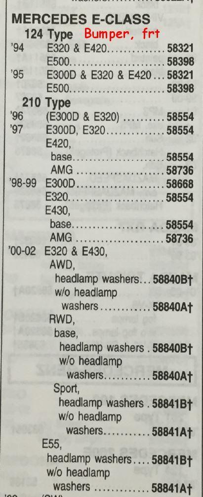

I am looking to replace the bumper and hood on my w210 Sedan (Had a little fender bender). I found someone with a W210 Wagon in the same year/colour that I am hoping to strip parts from but I wasn't sure if the parts would be compatible or not. I'm guessing they are based on appearance but not certain.
Does anyone know if they are or have a resource that could tell me if the parts on both vehicles have the same part numbers?

Hollander Interchange Manual
Thanks! So here are the part numbers. Does not specify sedan or wagon. Would be compatible then?

Good news. Searching on Pelican parts, one of their aftermarket bumpers fits both the sedan and wagon. So I should be okay!

well, be careful, as you might still trip up depending on model/type. better to match using your VIN
