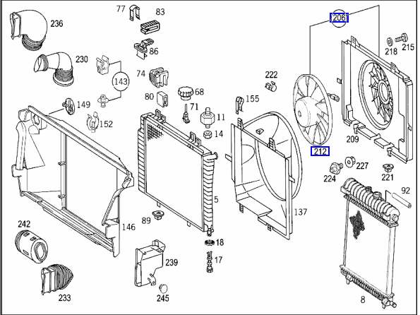

This is the setup I have, not the one with two adjacent fans. However, if I hold both Auto buttons on the AC unit for a few seconds I hear a fan spinning but that doesn't affect the cooling at all. The symptoms also appear when using cruise control on the highway. It seems that whenever the engine is not working hard ice-cold air takes a backseat. Oddly enough, when I was waiting in a parking lot I discovered that pressing the EC button twice would re-engage the compressor at max, resulting in ice cold air.

Well what do you know, I redid the test and manually activated the Fan when idling (held both Auto buttons together) , temps remained ice cold and the compressor was showing 20 on sensor #7!
Outside temperature was 36 C, engine temperature doesn't rise above 85 with the fan and AC on.

When the AUX fan is engaged the issue does not present itself at all. Should the aux fan controller be replaced then? Shows 0V on Sensor #20 at all times and never comes on. When I force enable it, it goes to 10V directly and cooling is exceptional!

Took a long (2h trip) with the fan forced on. #7 was on 20 at all times but Evap sensor on #5 still went up and down between 18/19 and 01/02 Degrees Celsius.
I've ordered the Evap sensor to be safe. WIS also mentions that intermittent cooling could be due to a faulty pressure sensor on the compressor that would communicate erroneous data to the AC controller.
A test for this is recommended by WIS and documented.

Originally Posted by kajtek1
I think such issue should be troubleshoot with advanced scanner. I would clean all the connections before jumping the gun.
If the part is cheap, swapping it might be good call, but it is always some gamble.
More updates:
Dealership appointment taken, will keep you posted.
