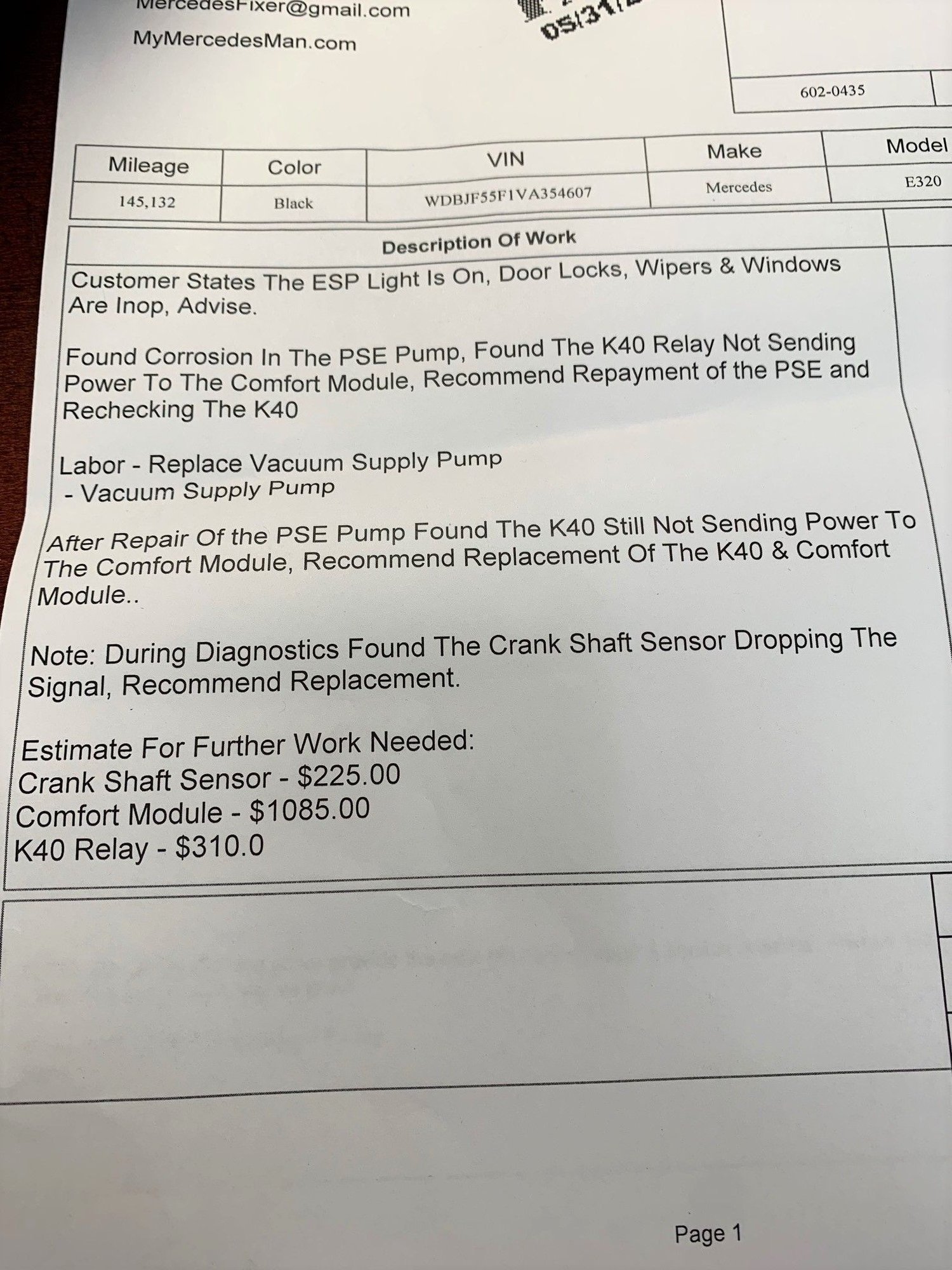

Here's the deal
My car was parked about 2 years ago and hit on the right front. The steering lock was jammed tie rod damaged control arms fender etc. I slowly but surely put the car back together. Once back together the windows and sunroof stopped working. The turn signals stopped working and the alarm was going off. Took the car to an independent mercedes mechanic and was told the PSE pump was bad and the CCM may be bad. Also told the Crank sensor was going bad and K40 was bad. Had the independent mechanic replace the PSE and brought the car home. Put in a new K40 and bought a new crank sensor( have yet to install yet car runs though) main issue is the windows and sunroof don't work, central locking and alarm not working, turn signals not working so the car is not road worthy. Trying to figure out what could be causing the problem. My car only has 146k miles and I love driving it. Just want it back on the road..

well that is pretty much the kitchen sink and without knowing the diagnostic results which preceded the action,
I'm not sure what to recommend. I feel you need the SDS to isolate trouble spots and causes instead of relying
on secondary symptoms. One red flag is that the immobilizer activated so until that has been resolved with
certainty, it may still be partially in effect. the PSE pump MAY need to be introduced to the car via SDS
if the donor car was not equipped the same as your. but like I said, there are a whole host of devil in the details
not mentioned so each symptom will need it's own flow chart to isolate and investigated to determine if it is
a problem of it's own doing....or interrelated to something else on the food chain. it may be way more than can
be done via keyboard/Internet and without an experienced person with diagnostic skills on hand to process the
troubleshooting flow chart.

This is the bill I got from the independent shop.
