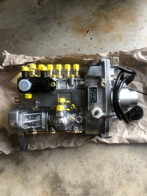

Fuel Injection Pump
I have had this code and it ended up being the fuel injection pump. I replaced the pump and the car runs great.

RKP Waco's Avatar
Joined: Jan 2016
Posts: 63
From: Waco Texas
1999 E300
It’s confusing, but like I said the P0200 code is the fuel injection pump, because it’s the only thing electronic in the fuel system. Also, I’ve had two cars with this code, the first one I took it to the dealership and paid for them to tell me this. I changed the pump and the code went away. The second car years later had the same code, I changed the injection pump and the code went away. Today, I now know how to fix the problem myself, It’s the solenoid that drives the rack in the pump. I’ve swapped out the solenoid and the code goes away.

It’s mounted to the side of the engine, it’s the injection pump.

I do not and you can’t order one anyways. It would have to come from a Bosch repair shop and they won’t sell them, I’ve asked.
