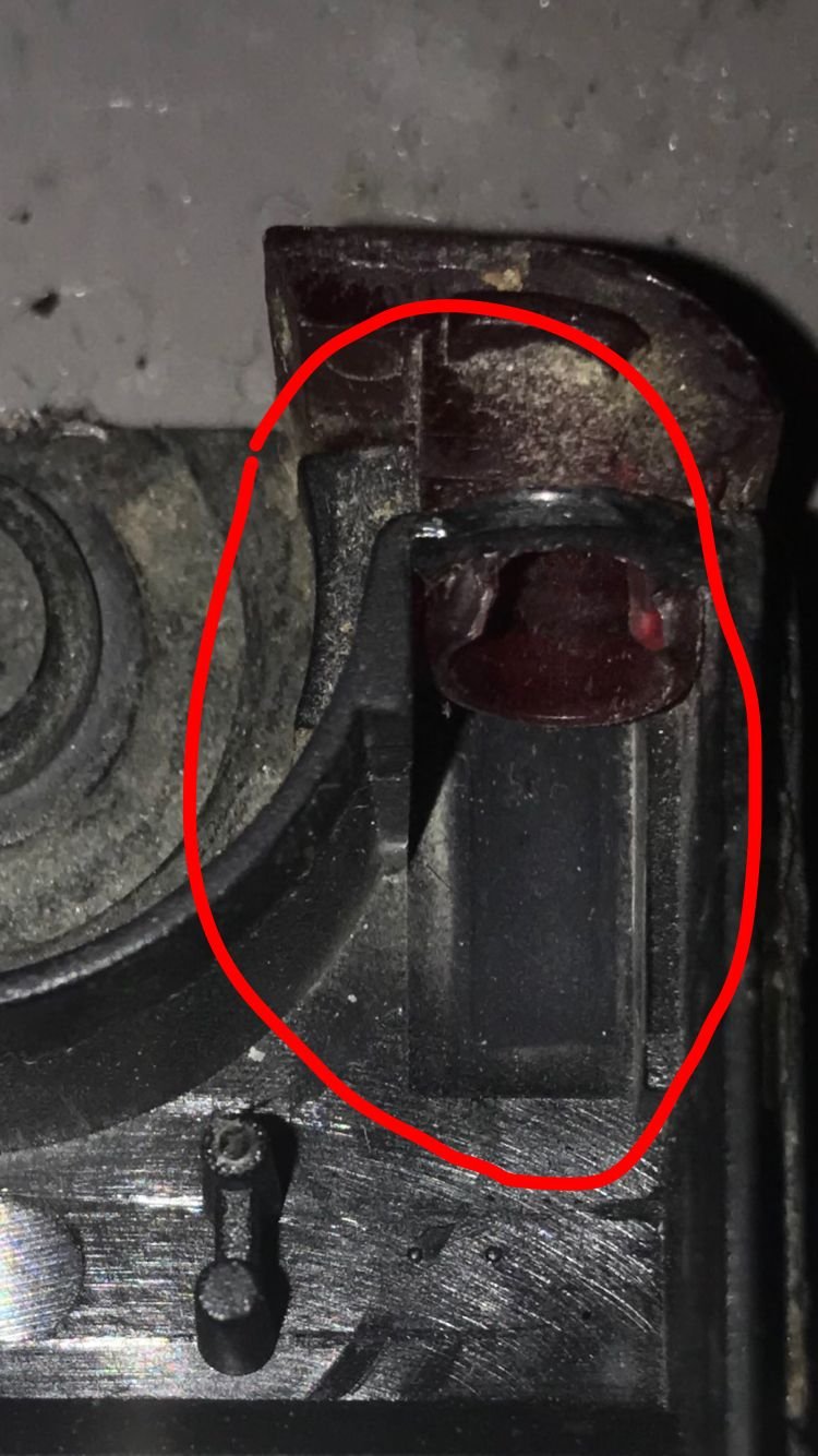

probably something wrong with the transponder in the key..becuse the injectors are not kicking on,Wish i just could bypass the damn immobilizer probably not that easy..one thing more is that the alarm does not go off when i lock the car (me inside and opens the Door)
edit: the transponder is gone in the key I think?
But can i change the immobilizer and get the the key that Belongs to that ”specific” immobilizer? Or do have to change the ECU and everything?

Lost the pea-sized transponder in the key fob?
Only way for that to happen is the case opened up and it (located in the tiny corner compartment) fell out.
Start looking, back racing your steps.
That chip is married to your system. Only other option is to the stealership for:
1) replacement key fob (possibly with the vehicle and/or proof of ownership) = $$$
2) valet key (same as (1) = cheaper
OR, I believe, you need to replace the entire system with a matching system with keys and cylinder too. = $$$$ and time
Correct me if I am incorrect on this.

Is it that thing?
i mean i can get a ignition switch/steeringlock and the immobilizer from another car with the key everything It should work i think..as long as the key that are ”Married” to that specific immobilizer..but in all honesty i have no idea what om talking about,but that is how understand it should work (maybe completely wrong hahaha)

Is it that thing?
Yes, it's missing based on the photo you posted.

yeah..kinda figured that out becuse the key was in pieces when i got the car...damn previous owner
anyways i ordered a new ignition switch/steeringlock and the immobilizer/key from the same car hopefully that works..sadly it’s the weekend so no shipping...
