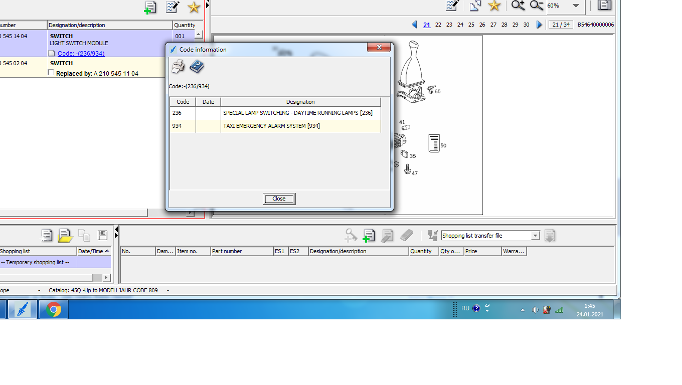

Hi,would somebody kindly help me.I need to change switch on my mercedes WDB2102371A337807.EPC gives me three numbers-2105451404,0204 and 1104.Would the first one (2105451404) switch on automatically running lights when the engine will start?If not which number is mine?Thank you.Regards

What do the footnotes for each of the 3 parts indicate?
Your switch description indicates you have DRLs for your w210 "...1404", correct?
So that is the part # you need for the built-in DRL (in the light control switch module)

Purchase the light switch that has the DRL automatically enabled in the module.
You can also, purchase a non DRL switch (ie.USA) from fleabay or fleabayUK, singapore ...) and wire it up to function as DRL.
Do a search - there are threads that discuss this.
