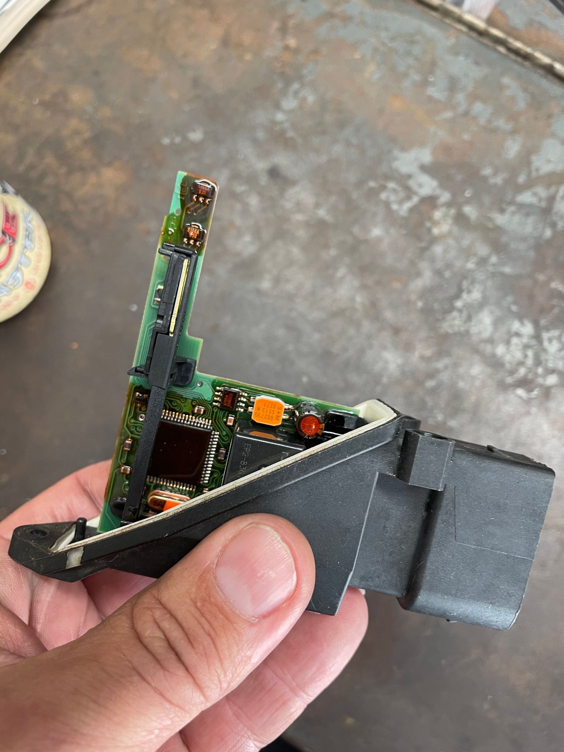

My front passenger door hasn’t had power to it the last few days. No seat controls, no window and no puddle light. I did some reading up and read that usually the RR DCM is the culprit. Today, I unplugged the RR DCM and the front passenger door had all power back to it. Is there a way to replace the DCM on the RR or does the whole motor/DCM assembly have to be replaced?
thanks in advance

Originally Posted by Plutoe
no the door control module is a separate part number from the motor. There are loads of them available on ebay google the part number and or look hMercedes-Benz Electronic Spare Parts Catalogue Onlineere
I searched on eBay and only front dcm’s came up.

Am I able to get this part or do I have to get the whole motor?
