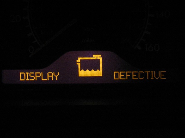

HELP!!cluster warning sign
hi..
i thought it's coolant level warning lamp..but everything just fine(also i checked windshield washer level..headlight washer level too..)
anyone know what this mean..?

You are low on LED fluid?
The electronics in you instrument cluster may have gone bad. Try unplugging it cluster to see if it clears. Otherwise you may need to have it checked. Some input to the cluster may be out of the expected range.

this message comes up in the IC when it is improperly programmed as well...it has nothing to do with any of the fluid levels...it has to do with data that goes into the IC (or might NOT get into the IC at the moment)...stardiag will tell you what the problem is...
