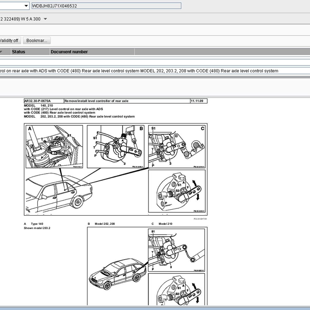

Old lines didn't survive being wrenched off the old self leveling valve. I'm replacing half of the T and P lines but after cutting and removing, realized I didn't mark. The T is the return and P is the pressure, am I to assume the pressure line is from the tank (the line under the car currently dripping fluid) and the T is the line to the alternator side of the car?

For anyone following along. T stands for Tank, P stands for Pump. So the tank line and the pressure line are self evident. So is facepalming after not realizing that for a week.
