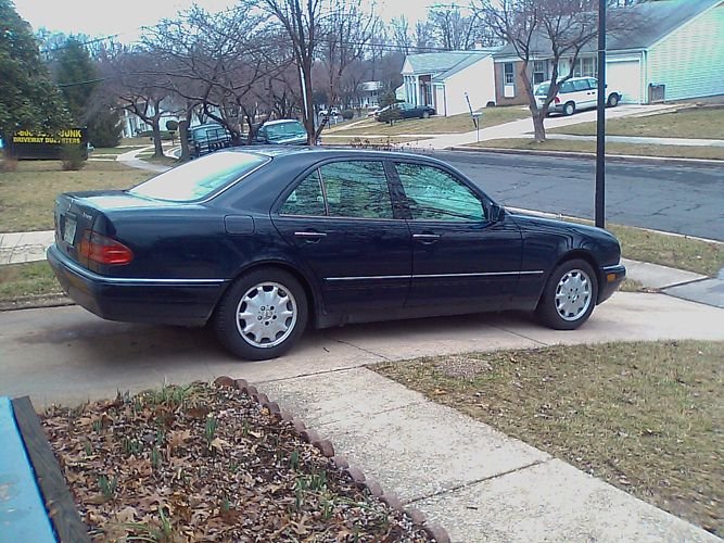

offsets will depend on the size/width of the wheels.
If you find 17s or 18s from a w210 they will fit. Going up in wheel size will change how the car rides but it will look nice.
My old car
16s
17s
18s from a w211
