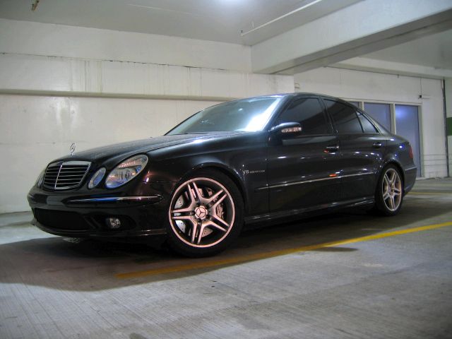

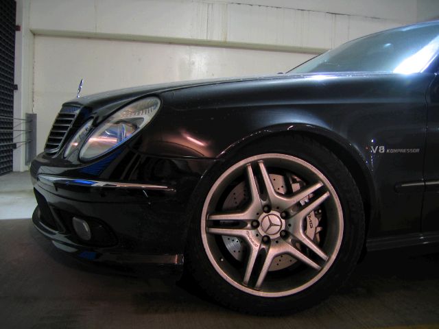

I originally posted this in the E55 forum but this mod is a cross platform thing and I know there has been come controversy over this mod - but let me tell you, the work Steve did was top rate.
Last saturday I had Steve from MBenzNL perform his lowering technique on my '03 E55 via STAR Diagnose. It basically involves lowering the voltage settings to each of the corners evenly and still keep them within the factory specification range. It will vary from car to car how much he can do but I was able to get a full inch through this method and the car's suspension settings are still within original factory specs, meaning NO possible service issues. It looks great and I can still raise the car 3/4" of an inch via the raise suspension button. The car does feel a bit more planted now in turns as the center of gravity has come down a good amount but the ride comfort is still there. For what he charged you absolutely cannot go wrong, there is no putting in links and risk service issues, and there's no module that cuts into the factory wiring (which basically does the same thing as what Steve does, just using a piggy back computer to do it). This is by far the best way to lower your car, you get a good amount of drop, it's inexpensive, it's completely reversible, and best of all the car is still within factory specs. A no brainer.
Here are a few pics. I hope you enjoy. Steve is a great guy and did a wonderful job on my car (he also installed an '05 US COMAND in my car). Thanks Steve.

How much lower is a stock E55 vs a stock E320/500 in sport II mode?

Originally Posted by Paul Le Corre
I wouldn't so sure about the warranty issue. I don't want to say that the job is bad but from what i have seen MB dealers are more and more tight with this kind of issue and unlike a famous tuner, you don't have any guarantee from the one who made it (or you didn't mention it)
Paul,
How can a dealer deny warranty work on a car that according to MB's specifications is a stock, factory spec automobile? They have no idea what my airmatic settings were before, and if they hook in the STAR Diagnose and check the settings they will see that all the voltages are within Mercedes specifications. There is no record of any changes whatsoever.
