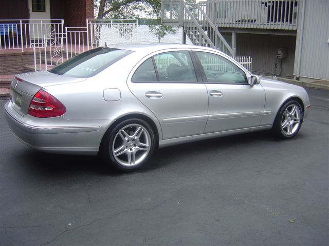

Take a look at the picture below - these are the 18" AMG's on my car without being lowered...

If it is any help - the tires in my picture are as follows:
Front 245/40/18 - Rear - 275/35/18 - No lowering.

I disagree - on the E Class W211 lowering is not necessary at 18"
Nothing is necessary I agree but if you could stick your fore arm in between the wheel well and the tire than it needs a drop. Unless you are on the east coast where road conditions will not tolerate it.
Old Aug 28, 2005 | 07:45 PM
birdman-c's Avatar
Almost a Member!
Joined: Apr 2005
Posts: 47
I don't think you have seen an unlowered W211 with 18" AMG's on it in person. The pictures don't do it justice as it is on an incline with the parking brake on. Looks just like a stock E55.
