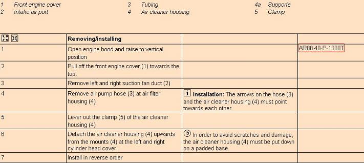

Apr 1, 2006 | 09:48 AM
Do you have any photos about where to remove the front cover? Because i dont want to break the anything.

Apr 1, 2006 | 07:09 PM
pull the (1) upwards.

Apr 1, 2006 | 08:52 PM
Quote: pull the (1) upwards.
Thank you so much about your photo. Do you have a bigger photo? Do i need any tools to lever up the engine cover? Please try to mark the positions in my picture. Thank you again!

Apr 1, 2006 | 11:07 PM
hope this helps...

Apr 1, 2006 | 11:26 PM
no tools needed.
