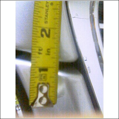

Hi,
I have this gap in my hood that's driving me crazy... it seems like a really wide gap for a certified MB... has this car been in an accident? It did not show any kind of accident when i purchased it thru a MB dealer with the carfax report. Since this is a certified MB, would MB repair this under warrenty? the rest of the hood alignment seems to be ok as in the second photo... this gap seems to get wider as time goes by also... weired!
any suggestions would be greatly appreciated!

Whoah, that is a huge gap! I'd take it back to the dealership and have them adjust it.

check car fax and make sure it's not been hit before. Eitherway, wholly unacceptable or a MB, take it back and demand it be made correct.

If you happen to go to the bodyshop just ask them to measure the paint thickness on the hood.That will answer the accident question.

Looks to me as if its been hit and perhaps the fender replaced. Carfax does not know lots of stuff that goes on and in fact I think its a joke. Much of this stuff is not reported.

Here is the result
After taking the car back to the dealer. They examined the car to death to make sure the car has not been in an accident and agreed to fix the gap. They had to remove the front bumper and reinstall it!
http://pg.photos.yahoo.com/ph/dennis...cd.jpg&.src=ph
The gap is down from 1 inch to half an inch...
I can't say that i am satisfied with the result.. but it's pretty close?
should i go back and complain more? or just be happy they fixed it under warranty

That "repair" would not make me happy. I'd go back and have it done correctly.
A new Malibu has tighter gaps that 1/2"!
