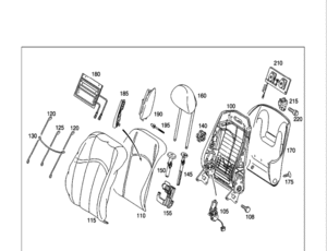

The heated seat element on the back of my driver's seat is suddenly very hot. Uncomfortably hot. Can the element be replaced separately or do I have to replace the entire seat back?

Doesn't look like it from the parts diagram, but I'm no expert. You may want to explore http://www.detali.ru/cat/oem_mb.asp which is where I got the parts diagram from.

The Heated seat pad is sewn to the leather seat cushion ..YES you can get the pad also look on the EPC for the pad on a W202
The heated seat control switch has a couple settings try just one led setting instead of all the lights on at the switch

Odd but it looks like it is only available with the cushion (see 873 option code).
