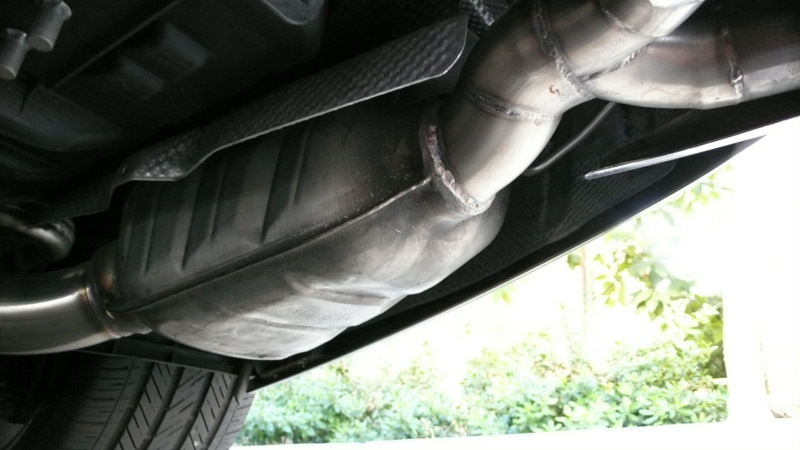

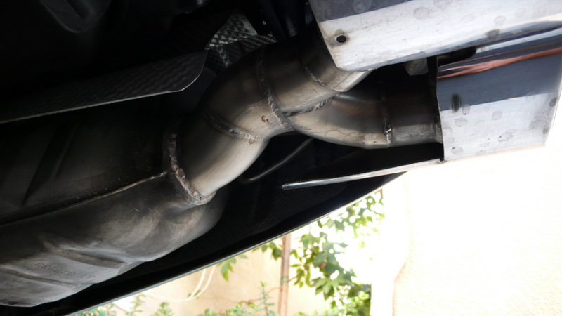

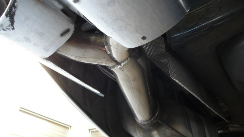

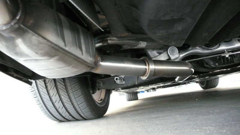

delete resonators+custom exhaust piping+ SL55 AMG mufflers+E55 AMG tips= hm...might be too loud for me

Yeah, youre right, take the whole thing off and ship it to me, YOU'RE KIDDING RIGHT? Man, it sounds AWESOME. The only thing to consider, and only you will be able to tell, is how loud it is inside and if there is any wierd resonance. If it bugs you at crusing speeds, then it will become a pain real fast. Otherwise......
Great job.....

thanks, theres is def more sound in the cabin. but it is very minimal. i might just be able to handle it. i see.
maybe i will add high flow cats later on.

But are you getting any droning inside the cabin at say...1800-2000 rpm under load? I had that with my previous magnaflow setup and couldn't take it.

no. no drone. with my current piping and e55 mufflers i had a very little amount of droning. with sl55 mufflers its pretty much not there.
magnaflows are hell. (well at least that how i felt when i had them on my e320) it was just droning like crazy.
i spent a good fortune on putting e55 tips on sl55 mufflers, could have actually bought a nice aftermarket system. but most of them drone (in my opinion at least) but i think i am happy with my current results.
