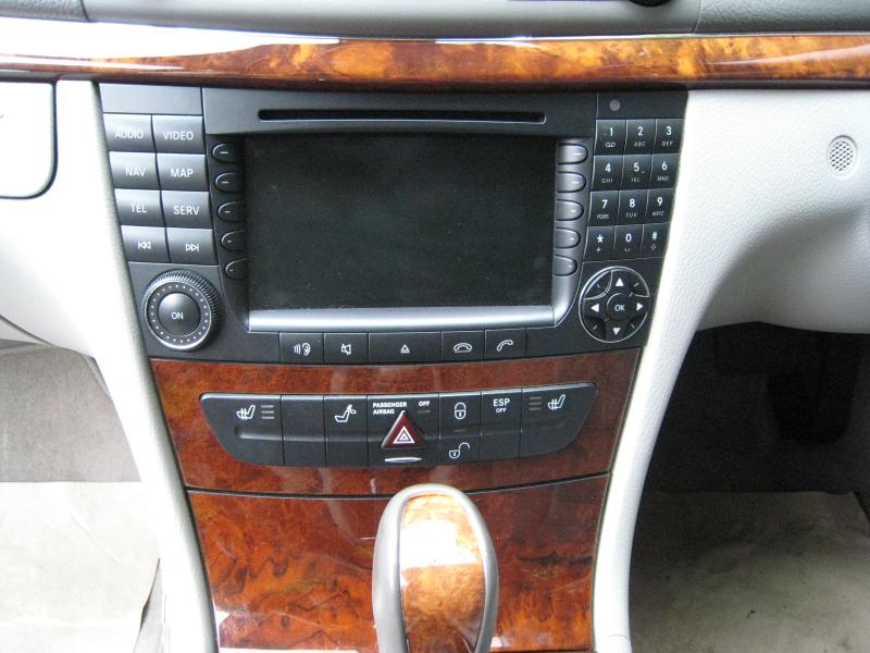

Fellow experts,
I've been searching high and low for a reverse rear camera integration with the existing COMAND APS Head Unit. Kindly advice whether the following item is sufficient to complete the mod?
Adjustable No Plate Rear Camera: http://boyovta.com/products/vtl200.html
Control Unit: http://www.kolumbus24.com/Datenblaetter/11000933.pdf
Alternatively, I would really appreciate if there is better way to resolve this. Many thanks.

I think that will work, but everytime you want to see the camera on teh screen you will have to switch the input on the Comand... becuase i didn't see an auto switch wire for reverse lead. I am doing a camera on my car too, but i went with a lcd rearview mirror with auto video on for reverse camera, and then am also running the rca to my Comand, if i want to see the camera on my comand screen. There are also ways to get a video module to have auto sensing for reverse camera, but it's more expensive and some require radio modification.
