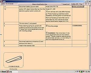

I need to replace the passenger/right side mirror glass on a 2009 E350 (North American, if it makes any difference). Could anyone provide me with any diagrams?

OK, wrong forum. My WIS is not as modern as 2009 - but these parts might not have changed for your E350.
Regarding the 'wedge' tool shown, I guess you could fashion something out of a piece of hardwood.
Once you have released the spring, it looks like the glass is still being held by 'arrests' which are dislodged by the wedge.
I cannot visualise exactly what these are, distibuted around the unit, so after you have completed this job perhaps you could post back and advise us..

thank you all - i'll try this as soon as i source the part..

Mirror glass part #2118100821 (parts.com $65.55) - attempt warranty replacement if steadfast on DIY, PM your email address and I will send the 09 WIS.
