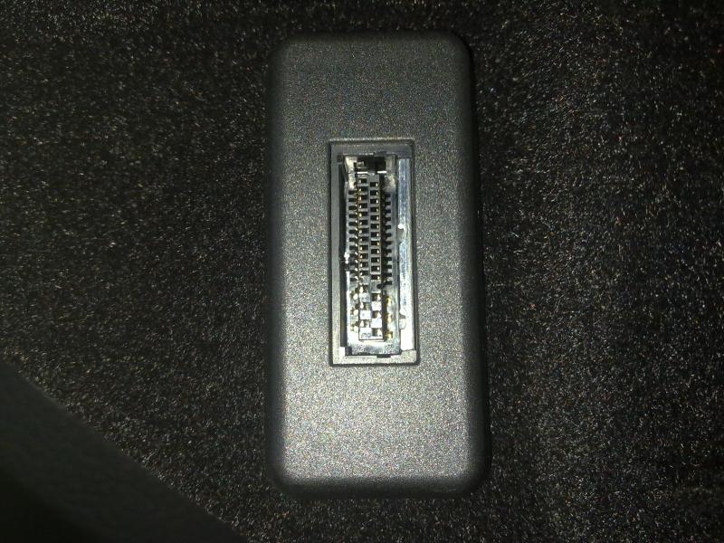

I dont understand why I would need the full Ipod kit as there is already the interface in the glovebox for me. It is not a 3.5 jack, but rather a fancy looking connector (i'll post a pic later on)
found these on the web. is this what i need and what is the difference between them?
http://www.comandonline.co.uk/Media-...LK-SL-SLK.html
http://www.comandonline.co.uk/ipod-5...ging-lead.html
also this looks tidy for holding the ipod in the glovebox
http://www.comandonline.co.uk/produc...cat=275&page=1

A001 827 8404 cable to play and charge newer Ipod/Iphone (5v/12v)
A0018276904, A2048270504 cable to play and charge older Ipod (12v)
Should be all you need!
The first link you put should work, the second link is updated cable for non MMI option cars with i-pod kit that allows charging of newer ipod/iphone.....
