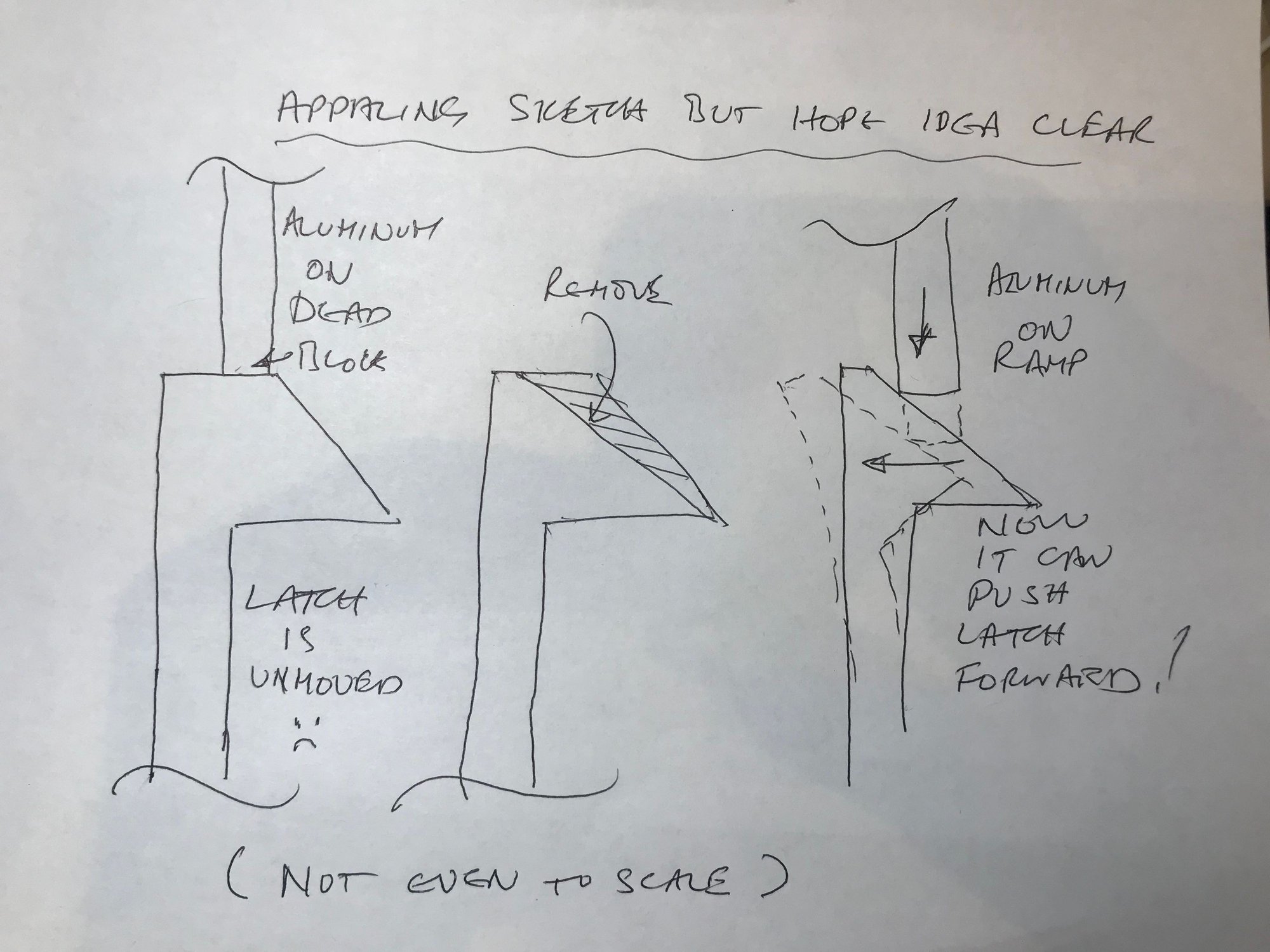

A teensy mod to help gesr shift cover replacement
Same issue tonight, first time removing it (part of replacing rear HVAC registers)—so pleased to find this thread, thought I was going nuts!... after reading all the posts above, both squinting with a flashlight and via boroscope, it appeared—with cover resting in the position from which it refused to snap down—that the aluminum catches were sitting on the somewhat large flat top of the plastic latches, so they couldn't respond to gentle or less-so persuasion (surgical blows with fist) as they weren't on the ramping face of the latches.
I got a 3" length of a broken flat ******* file (why asterixed out? That is what they are actually called!) and made a few strokes across the sloping faces of both plastic latches at the same time (the short piece allowed side-to-side filing with no risk to surrounding trim), reducing the pesky flat top and increasing the horizontal width of the ramping area. I went with a slightly shallower angle rather then parallel to original so as not reduce the horizontal latch width—the surface that latches against the aluminum.
(M^2 sketch below)
On trying to replace the cover this time, there was a stiff but springy resistance instead of a dead block... a couple of calibrated blows with the heel of hand and it popped perfectly into place.
It looks as though the square aluminum projection in its raised hole can bend the base material (that the latches are part of) with forward pressure on the cover, which would rotate the latches forward—seems like that's how the latches may unhook and explains the instructions for cover removal?
The cover's aluminum projections need to land on the sloping part of the latches to bend latches forward with downward pressure, and allow the snap action.
