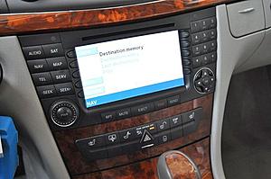

I have tried to attach a picture of the display when NAV is selected.

My guess is the dealer is posting pictures from a different car. Thats the screen I get with NAV.

Its a very odd screen though... According to the screen, you can only look to navigate to locations you have previously memorized into the Memory, yet there are no previous destinations available to see. Nor are there any POI's... nor are you able to manually enter a new destination into the system to Navigate to. Something is not right with the Nav which apparently IS installed in the car.
I Imagine, if the car thought that there was NO nav installed, when you press NAV the screen would display "Navigation Not Available". The car obviously thinks there is Nav installed because that NAV input screen is coming from somewhere other than the COMAND.

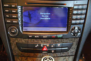

I have the same unit. When I press the NAV button it displays the message "Navigation Device Unavailable".

Buggy's photo is exactly what comes up when you press the NAV button. His daylight shot makes it difficult to see that just below "Destination Memory" is "Destination Entry", "Last Destinations" and "POIs". You can scroll to any of them and input information as necessary to Navigate.

They're there but they are "Blanked out" or faded out. They are NOT choices available to him or they would be darker in color. They are inavtive choices.

Sorry, Barry, but I'm going to have to disagree with you there. The choices are there and they are just a very light color in the daylight mode. I took a picture of mine just now and they are very light, but if you scroll down they turn dark and you punch the OK button and they activate. If the car does not have NAV, I don't think you can even get to a screen like this to begin with.
