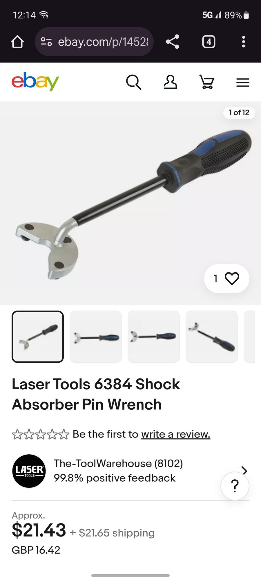

Found the tool on ebay
https://www.ebay.com/p/1452870115

That tool is the same one I just bought. It’s the only one I could find. That’s okay as I need it for my wife’s S211 as well, so it’ll get used!

I just installed the Bilstein rear semi-active shocks on my ‘04 E500 Wagon and they went in with no issues. The special tool was worth the weight as it made loosening/tightening the top nut really easy and it would have been much more difficult without it.
