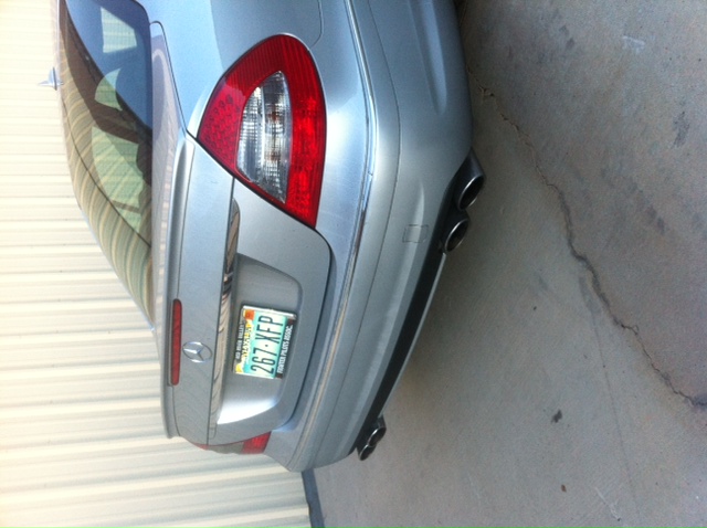

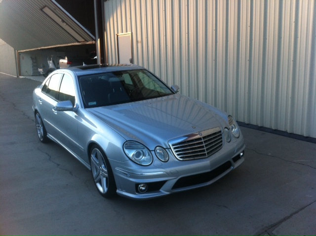

Finished update -
I finished the update to my 2008 bluetec a few months ago - I'm very pleased with the results. Here is what was done:
1. Complete E63 bodywork including front / rear bumper, side skirts, trunk spoiler.
2. E55 brakes front, E63 brakes rear w/ new SS lines
3. Swapped interior trim from brown to gray birdseye including steering wheel and keyless go shift knob.
4. Installed Eibach lowering springs
5. Installed new MB 19" wheels - very low cost from parts.com and look fantastic.
6. Installed Kleeman controller
7. Installed E63 mufflers / tips
Here are a few photos - they really don't do it justice.
Attached Thumbnails 2008 Bluetec E63 Facelift-photo-5-.jpg   2008 Bluetec E63 Facelift-photo-6-.jpg   2008 Bluetec E63 Facelift-photo-7-.jpg   2008 Bluetec E63 Facelift-photo-8-.jpg
