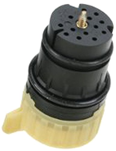

Are you doing a full flush with filter and 13 pin electrical transmission plug? If you do make sure you get the OEM Mercedes 13 pin plug since aftermarket can have the incorrect O-ring specs.

Pilot bushing is a must and also get a can of MAF cleaner to give the plug good bath.

Pilot bushing has orings on it, who age and leak costing electronic shorts. Orings are not sold separately, so you have to spend 10 bucks. Beware that new orings are hard to push in and don't bend pins in the process. Lube new orings with ATF and pay attention to the bushing position. Best -take a picture of old bushing before removal.
The best price I found was on Amazon sold under Mopar brand, what is original MB bushing made in Czech Republic. Part 2035400253
Avoid other brands.

The transmission is filled up with ATF and having electric plate inside.
Pilot bushing seals connection between plate outlet and outside harness plug, otherwise the ATF would drip on the floor.
Unintended effect is that when internal oring leaks and external oring holds - the ATF is carried by capillary action up to TCU making additional mess there.

I have a faulty plug in my w211 wagon. (pins are wet)
its the 7 speed (not 4matic) .... has anyone put in one of these new plugs?
its a pan drop from what I understand.

When this plug is wet with trans fluid it shifts weird.
now all my searching for plugs show the white 1/4 turn plug ... and I have one of those. But this one is different.
