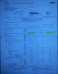

My car has the alignment done recently (see attached) at MB with the camber bolts installed, and tires have been rotated recently. I have read online that wheel/car can pull to the side with less negative camber (more positive camber).
On the alignment report:
Front Left Camber: -0.56
Front Right Camber: -0.53
Rear Left Camber: -1.18
Rear Right Camber: -1.28
So, technically the front would pull to the right, and the rear would pull to the left. Would it explain why the rear of the car would drift left (driver side), and the front is pointing to right (passenger side)?
Should I take the car back to redo the alignment?
